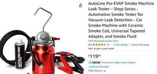

I have one by a company called autoline
Amazon link
I like it, makes lots of smoke. They only need a tiny amount of air pressure.
Bonus points for made in USA
I see they have another model that has a built in compressor.
You might look for a couple accessories also, these are handy.
adapter
cone

The Amazon link doesn’t work for me.
Can you be more specific as to which model you bought?
