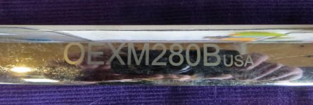

Yeah the etching throws up red flags. I don't think snapon would do that since it could easily become obscured or worn off
toddacimer
Sep 23, 2012
757
Oshkosh, Wi
That's odd. Not sure why it is etched like that rather than stamped
My only thought is that it could be a special limited quantity wrench made for a specific company or military customer.

Yep, looks fake. Good catch 2Steigers!
Somebodies' gonna be pissed. I bet when it's sitting in a set of authentic OEXM__B's it stands out like a sore thumb.
It does say "USA" on it.
Zedexseven
Nov 2, 2013
236
The laser etching does not look normal but it certainly could be due to a custom or low production model. For what it's worth they do make a 28mm wrench

Man, I don't know....I was sure that was fake when I first saw it. But as I look harder at the pics I'm not so sure. I went and glanced at some back catalogs and Snap-On hasn't listed 28mm oex wrenches before including their latest catalog. I wonder if it's too new to be in the catalog as in just added to the lineup and sporting a change to laser etching, which I HATE. Thoughts?

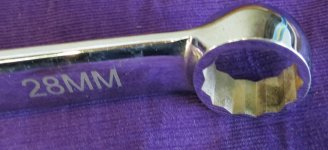

"Laser" etching is a relatively new phenomenon. Flank drive, however, has been around for decades to my knowledge. That box end is not flank drive. I give a big :thumbup: to it being FAKE.:beer:

Sometimes Snappy gives us dealers promotion wrenches laser etched with a promotional saying. But it's a REAL wrench that has the part number and size stamped/forged on it. Nothing like the one above.

Their standard 12pt combo series OEXM(mm) aren't flank drive plus (open end.)
As for flank drive, the auction's 4th picture (1st of the box end) sure looks like it is. Along the left side, two teeth of the 12pt section have a curve to their face that contacts a hex fastener.
I've only heard the laser etching to be less durable; haven't seen it for myself.
I bought a 1/2" 3/8" drive flare nut crowsfoot a year or two ago and it was laser etched (my 18mm FN CF is older and stamped of course.)
As for catalogs & websites being comprehensive, I don't find their lacking a 28mm in listings to be evidence either way.

Yes I looked at those yesterday. My only beef was with the box end of that one wrench. There is a distinct peak and valley on each of the 12 points. You hardly see that anymore.
I just dragged the photos off 2 more of his auctions for other OEXM____B series wrenches to compare the box ends only. Unfortunately the 20mm and 24mm aren't as sharp a photo as his 28 was but you don't see that chiseled look in the peaks and valleys, it's just that one wrench.
Maybe it's possible snappy made the 28 as special order and the only broaching die they could find at the factory for that size was an old one.

Agreed. That is not a flank drive end. Flank drive has rounded broaching, not the sharp points.
