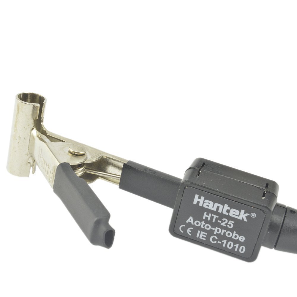

I am wondering about the timing light clamp as well. I can get the 9-pin AMP connector to connect the clamp to the MT1665 harness.
What I do not know is if all the clamps are equivalent. Some literature calls the clamp "inductive" and some "capacitive". Is there a difference?
The MT1665 Manual calls the coil clamp a "Remote Coil Capacitive Pickup" in the parts list and the clamp for the spark plug wire is an "inductive pickup".
Anyone have some knowledge about inductive vs capacitive?
I'll contact AESwave tomorrow to see if they have a clamp that will do the job.

looks like the one for the coil wire here
https://www.picoauto.com/products/ignition-accessories/secondary-ignition-pickup-capacitive-with-bnc
How to use the MI074 Secondary Ignition Pickup
Safety precautions before use:
  • Keep the lead away from pulleys and other moving parts
  • Keep the lead away from heat
  • Never let the pickup come in direct connection with primary or secondary voltage (otherwise the PicoScope may be damaged)
  • Always use the ground clip
  • Do not let the metal portion of the pickup contact a ground
Connecting the MI074:
  • Connect the MI074 to the automotive oscilloscope before connecting to the vehicle
  • Connect the ground clip to a good ground on the vehicle
  • Connect to vehicle
For...
  • Standard Ignition: clip the pickup around the coil wire (or one plug wire at a time)
  • Integrated coil: clip the pickup around the central location on the distributor cap
  • DIS: clip the pickup around one plug wire at a time
