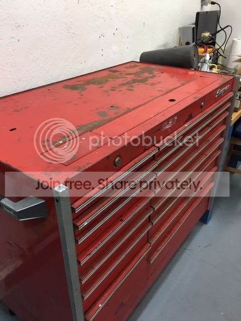

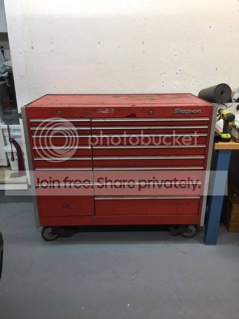

I'm re-organizing my shop and got hooked on the idea of consolidating my various toolboxes into one big boy. I don't go to the track any more, but I still keep my tools in various small-ish boxes (top chests, an army surplus hip roof, a few Rubbermaid totes) and my new mill came with a cheap-o rolling cart that's taking up valuable floor space in my tiny shop.
I started looking for a Matco or Mac box on CL, but then my cheapskate self found a cruelly used Snap On and I talked myself into believing a $600 beatup Snappy was better than a well-cared-for $1500 Matco, so here we go...
Supposedly it was owned by a diesel mechanic who then left it in a body shop to collect overspray in all its drawer slides. And I'm assuming he also had a goat that liked to gnaw on aluminum drawer trim.
My goal is to get this looking "good-enough" by toolbox standards, and also make it into a workstation for my mill.

Here it is torn down, and mostly ready for blast and powdercoat. I did some hammer and dolly work on a couple of the drawers to square them back up, but I'm not going for concours quality here. It's a toolbox.
I read a few posts on here about using the special Snap On tool to disengage the drawer slides from the box, but I was able to drill out the rivets, and then knock them free with a wooden block and a hammer. Maybe the older boxes like this have a simpler dent/bayonet system?
Anyway, took about a day's work and 64 oz of Sierra Nevada Torpedo Ale to get the trim off, slides out, drawer liners out, casters off, and the big dents turned into smaller dents.
