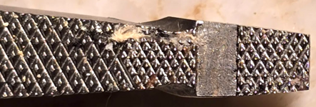

Hello, I recently received my first snap-on tools…the 7 and 9” long nose slip joint pliers, ordered from their site.
Upon inspection I noticed inconsistencies between the jaws of the 7” near the tip. Before I ask SO CS, I wanted to see if there is a reason for this because when I google images, they ALL seem like they share the same “issue”.
Does anybody have any insight? I don’t foresee any notable issues while using them, but I was curious if they are designed like that and for my first snap on purchase I guess I had different expectations in the form of the tool…and yes, that’s a Harbor Freight flier.
What say you?

I don't think the teeth are unusual. I just looked at my 7 inch pair and they have the same inconsistencies as yours :wtf:
I have two separate opinions on this issue. First, you're the paying customer and if you're not happy with the tool, return it. You're spending your hard earn money and should expect to receive a quality product regardless of manufacturer.
Secondly, I don't really look at the teeth on my pliers that much. I don't think the smooth spot will affect their ability to grip :dunno: The pliers work fine and the **** I use them on is far from new/perfect so, I'm keeping them and using the hell out of them but, that's just me. :beer:

Are you referring to the actual tip misalignment, or the flat spots?
The alignment is not that severe (unless you're a penny), and the
flat spots align when in the outer slip-joint positions for removing fuses.

I’m referring to the “step” on the smooth grip surface and the grip pattern at the tips going down the tip further on one. The slight tip alignment isn’t a problem for the reasons you said

I’m still trying to understand the problem. My pliers are the same way, so what am I not seeing?
The last 1/2” of the tips are machined differently. Most notably at the smooth part between the very tips and where the grip gets more aggressive. The flat part also has a “shelf” where I’m guessing the grip should be
The "shelf" is cool on your pliers. It seems to be for auto fuses. Go grab a fuse the two ways (smallest position and middle position) you can and you'll see the shelf lines up both ways on the fuse. The difference in the grind is for the middle position.
FigN⋅m
Feb 28, 2024
531
It looks like there should not be grip there - as in the 1st position, the teeth would be pushing against nothing.
It is a machining step to allow the fuse feature to align, but not have useless extra teeth on one side.
That’s the stuff I’m trying to learn. I did end up asking snap-on…not trying to get a refund or anything…just asked it this was normal or designed that way. She replied asking for my info to send a replacement. I didn’t even ask for one or say I was upset, lol. Just asked if it was supposed to be like that. So I’ll be getting a replacement here pretty soon. I’ll reply with a follow up when I get it.

I'd venture to say that most involved in this forum would know more about the tools than the administrative/clerical workers that Snap-On has hired in customer service. I could be wrong, but from how your interaction was laid out, that's the thought that came to mind. You'd likely have to get a technical person on the phone at SO to get your answer.
One of the tool reviewers on youtube mentioned the fuse removal aspect. I checked it out myself in my garage with a fuse. It looks designed to be able to pull out an auto fuse in two orientations. Pretty clever addition. Mind you I don't regularly pull out fuses, but have done so in the past with regular single pivot long nose pliers and it wasn't that well suited for the task.

Well, the new one came in. Same appearance! It has exceptionally minor differences than the original…the new ones have slightly narrower tips and the nut grabbing teeth are slightly beveled on one jaw. Those same teeth have rounded valleys in the serration too. I say these not to complain but in case anybody cares. The warranty people basically gave me a free spare I guess. I was not instructed to dispose of or return the originals.

here's my ln46acf if it helps. a 'shelf' in the flat part on one side is def normal.
imo yours is fine, but i have noticed some minor variances in the teeth knurling. i'd consider complaining if they don't feel sharp enough or something, but then again, that initial super sharpness only lasts so long once you start grabbing a lot of **** with them.
