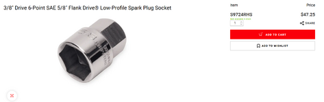

Ordered this socket online - just received it and it doesn't properly interface with my normal 3/8" drive ratchets. There is no hole drilled in the drive side of the socket for the drive gear (ball) of the ratchet head to click into.
Is this socket meant to be used with the Snap-on low profile ratchet or something? That's the only thing I can think of.

The plug is supposed to stick out the back of those and you typically use an open end wrench. These are not designed to be used with a ratchet wrench.

Got it, that makes sense. I guess the product description saying "3/8" drive" is what threw me off.

If you really wanted to, you could put a 5/8 deep socket on top of the low profile one and put a ratchet on the deep socket just fine.

The square drive was probably an afterthought since there was a hole there already for the plug to pass thru. As stated above there is a spark plug sticking thru the hole during use so can't use a ratchet or extension on it.
