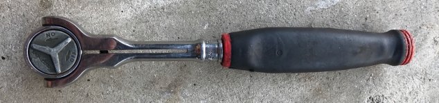

I thought I would share a couple of the Snap On Ratchets I have rebuilt.
I am including before and afters. The 936 had that coating that Snap On offered at one time, looks like chrome to protect the chrome, but is evil as evil gets. Flakes off and gets under your nails. Took 2 hours to get it all off.
The TH737 was rusted almost solid at the head but cam out better than expected.
Still struggling with keeping the handles perfectly clocked when pressing them on though.
That is the damaged chrome (chromium), the undercoating is nickel...that tool is trashed...:scared:
FYI, bare nickel has potential health issues....just look into that as I believe the topic is somewhat controversial .... as skin/nicket contact is more likely....its probably riskier on a ratchet handle than some other places it tends to show up (like cheap cman sockets).
edit: you can see how the nickel plating is darker than the chrome, which can be a/b tested nect to another tool, under daylight.
good luck.

However, this coating is more silver than chrome. What's under it looks like any other ratchet I have. It became very apparent when I put polish on it. The coating turned a darker silver and the layer under it brightened as chrome should. Another reason I am almost positive it isn't nickel showing is the fact it is very hard. I used a razor to scrape the coating off and it never phased the layer under it. Unless chrome plating is different that what was used on firearms, it would have scratched.
Also, I have not seen the chrome peel off a newer Snap On ever. Older stuff was as bad as MAC and Craftsman. But I am wrong a lot . . .
As for health issues, I am not worried. It has a cushion handle and when I work I am almost always wearing nitrile gloves. I guess I can't lick my tools anymore dang it!

OK as I was typing . . . I was just informed by one of the guys here, that looked at a sample of the peel, that the ratchet was, as he put it, powder coated by some F@#$ing idiot.

Well just called Snapon and they said you guys are correct, it is the chrome. They are replacing free of charge.
