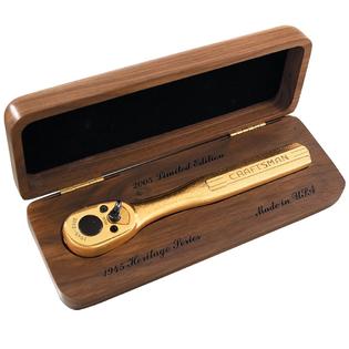

but the one thing they haven't figured out yet is how to satisfy the tool polisher.
Come on now, give the tool companies some credit! :bounce:
