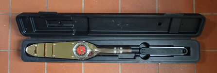

I bought a 100-600 ft/lb. Torqometer last week and I really like it. It had the typical Duracell battery rot, which had eaten away at the battery case's spring clip; I repaired that by drilling a tiny hole and installing a 2-56 screw/nut/nut combo to restore the missing case length, then used the new #112 lamp (E10 base, TL3 shape, 1.2v), which screws in, to adjust the battery compression. Works a treat.
The manual that came with it lists torque specs for common cars of the era, through 1964; I'm guessing mine is of that era.
My question is: I have the case for it, and there's a felt-padded spot for which something ought to nest, but I've been unable to determine just what should live there. Thoughts?
It's too low to accommodate the extension bar, which has been nesting where you see it for a long time, per the paint wear pattern. I wonder what that felt-lined riser is supposed to support.

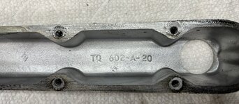

Here are few more pics of my new-to-me TQ-602-AL (the 'L' is the signal light option):
There are at least two variations of this metal case that I've seen; one has the "Snap-on" embossed on the top left, whereas mine is on the front face center as shown.
