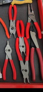

I have some that are labeled as Craftsman that were made by Stride. Paid about $30 on clearance down from about $100, the identical SnapOn set was closer to $200

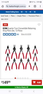

Harbor Freight has 12pc made in USA set for $150. Apparently 30% 10% off this weekend...
ETA updated sale price sorry my bad.

I believe these are only 10% off this weekend. I would pull the trigger at 30% though.
Damn deceptive marketing I guess I missed the "*" in No Exlusions * lol. Yeah looks like 30% is just for $20 or less my bad.
cgrutt
Mar 4, 2016
8,456
Snap-on can be obtained for that price.
I got nothing against snap on but not really apples to apples. The Snap on set above is used and only has 5 pliers vs the 12 included in ICON set. So dollars similar but not really same price...
