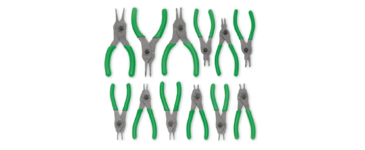

The additional “R” in the part number indicates the new set. The pliers are still the same quick-release reversible design, but the case has been redesigned to include removable tool storage foam that matches the color of the pliers.
Old set (in red):
New set (in green):
