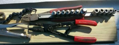

Here is everything I got for 155.00 with tax
There are 16 Mac Tools vice grips and 2 vice grip brand a Mac Tools chain wrench, and Blue point locking snap ring pliers and blue point wire crumpets
