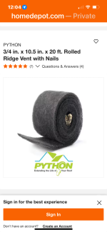

Sounds like a nice practical solution and what I had in mind (only better) It looks like its a breathable material, hence you still allow airflow. I was originally thinking window screen but this looks much better. That was my main concern on how to maintain airflow. I have heard some guys stuff in pipe insulation which would defeat the purpose of airflow… so this is what you’re referring to? I also found what looks to be a little more stout unit from Home Depot. It says its 3/4” thick (Python Brand). I’m leaning towards this and to stuff it into the cavity like you mentioned
That’s it, or close.
I think I used snips to cut it.
My garage is 54’ long, so I used most of two rolls

It’s not going to 100% stop fine, dry, wind driven snow. I put mine up over a couple of year (ran out of material and time at first), but I was up there retrieving things after a weather event when I was about half done. The difference between the completed and unaddressed portions of the attic was dramatic.
It did completely eliminate the windblown leaf shards.
