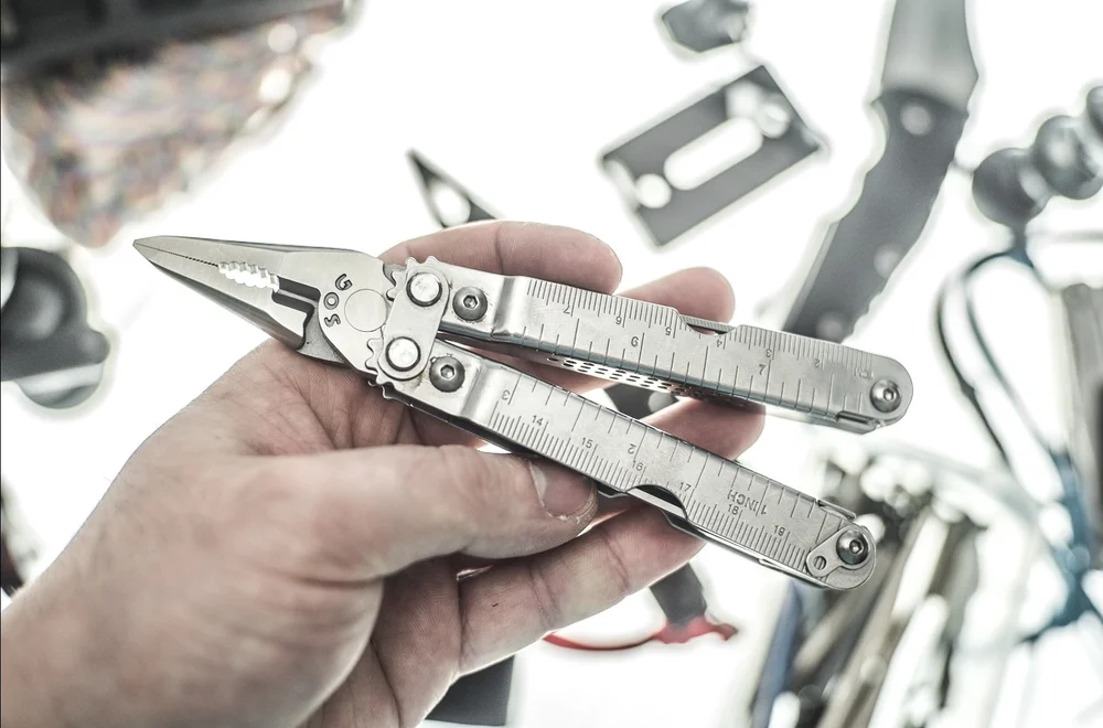

Love to compare the gripping power of the Snap-on to the Tekton posted above, or your Swanstrom. Bet there's a difference there, and it won't be what the rabble on this site think.
I bet the SOG S44 (made in USA) that I bought over 10 years ago for $15 has more gripping power than any of them.
The handles aren't as ergonomic as a real precision pliers but the SOG is better machined and works better than any real precision pliers that I've tried. Wish they made it with normal handles.
I seriously doubt any multi tool can compare to a real pair of needle nose pliers. I use a pair of 95ACF and 912AEP for precision work (computer motherboards, etc.) and never had any issues or real desire/need for the "electronic pliers" line.
You can rip a finger nail clean off your hand before it lets go with either of those two pairs of pliers.
Ripping finger nails off has never been useful for me. When I posted I knew it would be contrary "what the rabble on this site think" (in your words). ;) :D The S44 pliers are force multiplying.

If I put a penny in my vise, and unmount it from my table, I could lift up the entire vise with my force multiplying Snap-on pliers.
I'm willing to bet you haven't used both. I have. You could do the same with the SOG S44 while exerting less force since they are force multiplying. The SOG handles aren't at all ergonomic though.
