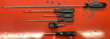

I’ve ended up with a few lots of tools recently which has yielded some of the older style Snap On hard plastic square handled tools - mostly screwdrivers, but also a 1/4” socket spinner. In using then I’ve found that I really like them, so would like add a few more to the small collection…
i’m curious as to what sort of age these are Fromm- when did the shapes change?
In researching I’ve also come across mention of SO handles disintegrating into a gooey mess. Are these the type that suffers from this issue? Are there any known ways of stabilising the plastic material or is that the end of the tool?
thanks

I love that style of Snap-on screwdriver. I think that was their first gen four-sided and ran up until the late 80's. I bought a set of used ones when I first started as an Industrial Maintenance Mechanic in 1988 and if memory serves the new generation of 4- sided hard handled just came out which I also bought a set of around 1989. Followed by a couple sets of the Instinct handled ones around 2001/2002~ish. I still use all three styles.

My other observation is that these seem quite collectible… so buying more may be expensive!
just by way of comparison, these are the other styles of handles I have. I really like the top one, quite like the middle one, but can’t really get on with the bottom style :/

The handles you refer to are called “contour grip”
They were introduced in 1962.
I don’t have a definitive date when production ceased, but zmotorsports suggests the new shape came out in about 1988, and I reckon he is bang on.
I bought a few of the contour grip brand new in about 86/87, and the new style was introduced not long after.
The contour grips were made of Eastman Tenite, which is a pretty high quality material. If you have an old handle with nicks and damage, you can actually sand it down and polish it, which I’ve done on some of these.
I too love the shape. It’s very practical for most purposes, and while the newer grips allow you to apply more torque, I have other tools for that.
The only downside is that the material can degrade. I’ve only found this to be a problem with one driver that was owned by my father. It was one of the Canadian made ones, which might be relevant. Other drivers show no signs of degradation, but maybe they will over time?
The newer handles (I forget the name) are perhaps more tolerant of knocks, but not quite so hard. I’m pretty certain the material used on the newer handles is a DuPont product, and is also first class. The earliest of these are now 30 plus years old and seem to wear superbly.

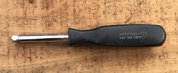

Stubby1743
Jul 16, 2023
718
UK
I bought this 1/4 drive handle in about 1980. After a few years the plastic bulged and split and I've not used it since. I guess that I ought to get it replaced by Snap On but I don't really like the current handles. I thing they're too big for 1/4 drive.DSCF9606R.jpg
