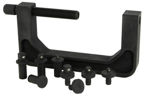

Do you think the one on the left will work? It's less likely to bend as a regular BJ press can. I have one but never used it on u joints.

I have the Astro Goliath. I need depth, not width, as the body of the axle shaft where the ujoint resides hits the body of the press before the caps are lined up with the forcing screw.
I needed a solid inch+. Normally my Otc or Astro C-frame does all my pressing. But the size of the joint was just too large to fit. I've run into this plenty trying to use a ball joint press to seat bushings, etc.
My OP description was incorrect using "throat" as the limting factor.
