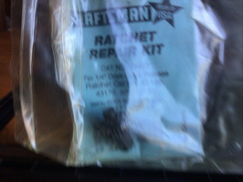

Sentimental value so you understand.
The ball doesn’t always come out to hold the socket on, but it does occasionally. Working under the dash on my boat yesterday and dropped an 11/32 socket that hit me in the teeth. Sounded and felt like an explosion!
Is there any way to repair it? I’ve soaked it in solvent and WD-40 with no luck. Seems then that it is mechanical, but there doesn’t appear to be a way to take the actual socket drive apart.

It's a quick release ratchet. There is no spring directly behind the detent ball. Trying to force it in is liable to break the damn ratchet (if it isn't already broke and sorta sounds like it already was).
The spring is in the assembly directly under the button and the button is a shaft that when depressed moves a tapered groove behind the ball so it can go in and let go of the socket. When you let off the button the tapered groove moves up and the thicker part at the end of the shaft forces the ball out and holds it there. That tapered groove can and will get boogered up over a long time or even get a crack or break of that shaft there (especially if you are trying to force the detent ball back in with pliers or whatnot), and this is a ratchet that is more than a couple decades old (perhaps 4, 5,6, or more). That's why at least until recently thanks to Sears' woes they had rebuild kits available for them, now limited to places like ebay.
If the detent ball on this type ratchet is giving you issues your best bet is to put a kit in it, or retire it / replace it.
The kit is super easy to replace. Use some needle nose to squeeze the circle clip (don't lose it) and the assembly falls out in one piece. Put it back in reverse.

After a repeat soaking with no improvement, I bit the bullet and bought a rebuild kit. All is good.
Upon getting a little more aggressive with poking around with the old assembly, it appears the retainer is no longer round. It seems like a chip in the ball more than wear, but either way I can easily see it being a problem.
