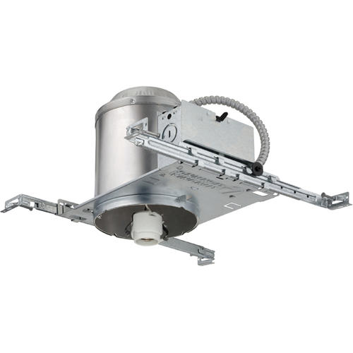

Well I'm starting the planning stage for what I want to use for my soffet lighting on my Garage. (45x22).
Im looking for some thing easy to install (use hole saw to cut the soffet). Low power draw (led's) but also worried if I use the china led's when 1 goes bad it would **** to replace. But I could also stock up on them so if that happens I could just swap it out for a new one. I'm not looking to light up the neighborhood, just nice accent lighting,
Perhaps 5" recessed lights? What have you guys used?
Im testing with a 3 watt China LED.( 3 - 1 watt leds per light) So far it has been fine. The light it self stays cool, the driver also stays cool, but dam bright at night. I see they have dimmable ones also, so that is a option. These just need a 2-3/8" hole that I can use a hole saw to make the hole.
Also how far should I space them?

I have a version of those in my soffit and they keep burning out; cheap led driver. It takes about 6 months to a year for them in my case to start acting up. I have had 100% failure on two rounds of the same lights (superbright was nice enough to send me replacements). It could be that they are burning out because my soffit in my garage in florida gets very hot but it still *****. Pretty soon I will get a good led driver and run the set off those directly. The lights themselves are good.

Thank you guys! I was afraid for the failure rater with the China LED's and drivers.
So maybe a 5" or 6" recessed light fixture would be the way to go and just put the LED bulbs in them and easily replaceable when they burn out. Then use 6" or 5"
I don't think the soffet would hold the weight of a remodel style slide in light so prob have to use new construction and cut out the sofffet as I go?
New construction

My problem is the I don't have the depth to put something in like that. All that being said, if you bypass the cheap drivers and use a single good driver say $30-50, those lights you referenced (like the ones I have) should be totally find.

Ok, Ok, I see what your saying. I do have a 24 volt DC power supply. So the next would be to find out what voltage the LED driver actually puts out and if 24 VDC is to much

It's going to be something more like this (although you will have to calculate your load)
https://www.amazon.com/gp/product/B007A4LTLS/?tag=atomicindus08-20
That's what I'm using for my work bench led lighting or my kitchen cabinet lighting, I think. You can always throw up the lights, see if any of them flicker down the road and then go out and be prepared to put the driver somewhere in your current 110 wiring before the first light and remove all the individual drivers. That's what I'm going to have to do.

I am open to any and all ideas. Just not sure they would work on the gable ends. I want 360 accent lighting all around the garage. Share some photos of what you are thinking of.
I also have no problem with using recessed can lights in the soffet. I have plenty of room to fit them.
