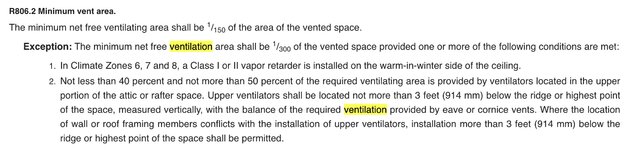

bdbecker,
Thank you for the detailed response. Do you interpret the IRC code as 1/300 of the attic area is the ventilation area needed for one side, exhaust OR intake, not the combination of exhaust AND intake area? In the code they say "net free ventilating area" and don't specify intake or exhaust. Also, when I read exception #2 it seems to reinforce that it's the combined intake and exhaust since they say 40-50% of the ventilating area needs to be in the upper portion of the attic space. When I first did the calculation before building I assumed the 1/300 area was NOT the combined intake and exhaust, but now I'm convinced it is the combination. Man the simplest things can sometimes be the most confusing for me!

bdbecker,
The 1/300 (or 1/150) rule gives you the NFA for just the exhaust or just the intake - you don't divide that number in half.
The 1/300 rule is the absolute minimum NFA a space should have, provided it meets the conditions noted (climate zone, vapor barrier, 50/50 to 60/40 balance). The 1/150 rule is optimal and should be followed whenever possible.
Now it should be noted that I am not in the trades or construction industry. Like you, I spent a bunch of time trying decipher what that section was trying to say when I was working on my garage. While I am pretty sure I am correct in my interpretation, I can't say with full certainty that I am. It is frustrating how detailed yet vague this stuff can be.
As I understand it...
If you meet the conditions for the 1/300 rule, you could get away with removing some of your ridge vent to ensure you have a 50/50 to 60/40 balance with your soffit intake. That means you need a minimum 296 square inches of NFA for your exhaust, and at least 296 square inches of intake. Intake doesn't need to be 296 square inches per side, its just a total value. So if you wanted to calculate how much intake for each side of your structure, you can divide that by 2 to give you at least 148 square inches of NFA intake per side of the structure.
Same goes for the 1/150 rule. In your case, you want at least 592 square inches of exhaust and 592 square inches of total intake (296 square inches per side).
