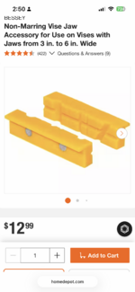

Does anyone have any experience making soft jaws for a vise? I have a couple of pairs of these slip over ones and I don’t care for how they perform. Thoughts on if brass, copper, aluminum or even oak would be the best choice?

I roll my own jaw covers from flattened-out pieces of 2" Type L copper pipe drops:
They work for me, and keep welding splatter from sticking to the jaws.

Depends on what you want to grip. I've used aluminum. I've made slip on covers from copper like hippie shows. I've made them from wood. I have 3d printed jaws to hold odd shapes. I've made them from steel when I needed soft but not too soft.

I have a pair, they work well for stuff you dont need to grip super tight. The main problem is they are magnetic so and steel filings and dust from sawing, filing, and grinding sticks to them, which is what the majority of my work with a bench vise entails. Copper jaws work better for anything of mild steel as a result.

-The example by @Beerhippie is what's very often found in machine shops. Instead of swapping jaws, which takes time, a pair of soft jaw covers is quickly applied. The covers used to be available commercially, don't know now, and were either pre-formed or in a flat pattern you wrapped around the jaws themselves. If done correctly, the covers will stay put on the jaws without falling off. The long tabs on the example above are key to staying on the jaws. They were often made of brass, but sometimes were aluminum, copper (shop made), or plastic (not as durable as metal). Jaw replacements can be wood, plastic, or a phenolic compound.
