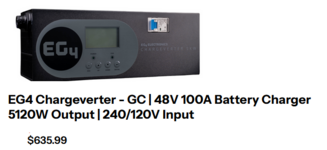

9600 watts / 240V (AC) = 40A available (240V panel power)
Consider load shed devices or circuit priority. A power backup where you overload the inverters and they shut down is going to annoy you. You CAN always manually drop the loads (switch off breakers) and restart the system if power is down.
This system will work great (with managed loads) on temporary outages - which is most of what I get in TX. Won't do much for extended outages.
What I'd do is add a "manual charger" that can assist solar (via portable generator) direct to the batteries.... That's your multi-day power outage solution at lowest dollar. EG4 makes a charger than can be run by a generator, direct connect to batteries.. It's a few hundred bucks.

I'm in TX. For those that don't know, we sustained a power outage than ranged from 1 day to over a week in Texas due to a "100 year freeze". Our homes are not designed for freezing, the resulting pipes that burst, inability for most consumers to turn off the water, etc, caused billions in damages.
This system will do little to help in that situation.
The other thing that the OP needs to consider is that when the grid fails, he's got 40A available for about 3 hours. Power will need to be managed (perhaps manually if nothing else is included in this bid). This is going to be fine in a "heating" situation if he's got gas heat, but electrical heat and AC timelines will have to be managed and will be short lived (hours, not days).
This system will work great for short term power loss, assuming his house is drawing less than 40A.
To put this another way, any payback is pretty much gravy.
The historical trend is prices have gone up 33% in 10 years for TX.
OP, I would definitely add one of these and keep a 5000-6000 watt generator on hand for longer outages, you'll still be limited to 40A, but this would make a long outage something that is manageable:
Not going to argue on the math. He gets kW per kW net meter, that's IDEAL for PV solar.
