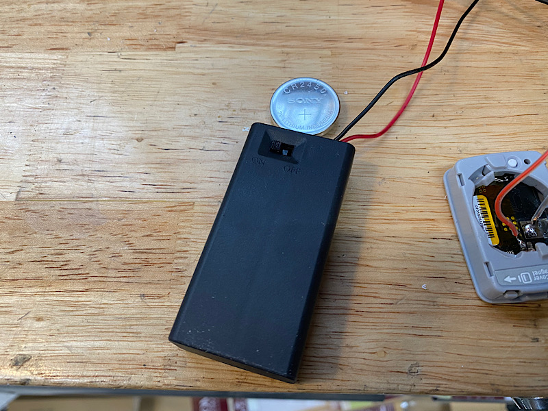

I also ordered some holders for 2 AA cells, with an on/off switch on Amazon.
I'm just using Amazon Basics NIMH rechargeable AA batteries.

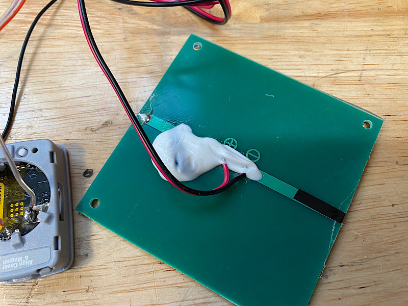

Bench testing the setup. Basically just connect up the + and - leads, and solder to the sensor. The sensor (with cover removed) is sitting between the AA batteries and solar cell.
Back of the solar cell (as provided by the manufacturer) where the diode is sealed under some silicon. This keeps the solar cell from draining the AA cells at night.
Battery holder (in series) with on/off
