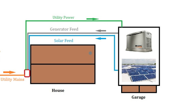

I am in the planning stages for a detached garage/woodshop and going through all of the future proofing steps regarding the electrical. My questions and scenario are for my knowledge and an electrician will be used but I like to know what I am getting myself into before hand.
The detached garage will be about 60ft from the closest point of the existing house built in 2018. The power meter is on the opposite side of the house on a walkout basement that wheels off about 230ft from where the garage's subpanel will be (includes 10ft on each side for vertical travel). This would be all trench with no obstructions besides the house and in conduit. I could shorten the distance by traversing the basement but I am not fond of putting another hole in the basement wall. I would like put a 100amp or less subpanel in the garage/woodshop as well as have the ability to tie in future solar panels mounted on the garage roof as well as a future backup generator. I would like to locate the generator there purely due to less noise for my ears as well as the neighbors (walk out is uphill and on front corner of house, detached garage would have it on the rear facing the rear five-ish acres).
My initial questions are:
1. It is feasible/realistic to have the generator and solar panel that far away given it will be fed using the proper gauge for the power and distance?
2. I am assuming I would need to run two different feeds the 230ft, one for the subpanel feeding the garage and one feeding the solar or generator to a future transfer switch/critical circuit panel located at my power main and house panels. Is two runs correct or can it be done with one feed between buildings?
In case it matters I am in NC about 60 miles north of Charlotte and in Duke Energy territory. I also have two 200amp Siemens P3040 panels directly inside from the power meter that are balanced to feed the house. I am not sure if they are both considered main panels or if one is a sub but there is no disconnect in either one for the other. Thanks for any input!
