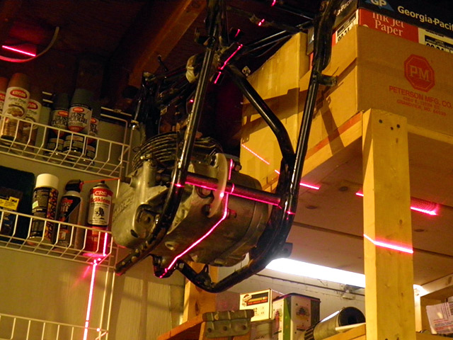

My 24" x 48" sheet of 3/16" HDPE arrived on Friday. I finally had a chance to play around with it this morning and the stuff worked a treat. :thumbup: I was able to make up the template I needed in about 20 minutes.
I used a 10 tpi blade in a variable speed sabre saw to make the rough cuts, which were admittedly pretty rough, but it was not supported as well as it could have been and was flexing all over. Keeping the speed down helped.
I read a web page about HDPE that recommended NOT using a pilot arbor when drilling large diameter holes in it, so I tried that method at the slowest speed (640 RPM), and had no problem at all. A lot of swarf curled up around the teeth, but as long as I worked through it in small steps, that didn't cause any problems. I drilled two 1/2" dia holes with a regular twist drill that went through cleanly and quickly.
The whole point of this was to positively locate the rear engine mounting bolts in relation to a frame cross tube. I made two separate pieces which I installed separately, then clamped together to get the relationship right. I then drilled a couple of holes for small machine screws before I took the clamp off. Once they were attached, I could make some accurate measurements, and make up an accurate drawing for the final 1/4" steel plates.
Overall, the HDPE worked better than I had been lead to believe. I can understand why it wouldn't work for any sort of precision machining, but I only needed to be accurate to about a quarter millimeter at the very most, so it worked great for me. I did have to de-burr the edges, but I did that with a combination of my thumbnail and a dull X-acto blade.

Tanshanomi
Sep 10, 2009
218
Missouri
Thought I'd share another photo that shows a completed HDPE template holding the engine in place as I worked out the side-to-side alignment. Stuff works great for my needs.
