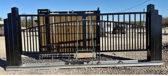

Just about every auction on the face of the planet sells decorate gates and fencing now, right next to the chinese mini skid steers and excavators. I am not sure if they come with opening devices, but in terms of having a ornate fence that can then be used with universal openers, I think they would be hard to beat. I have seen them with fabricated fish, deer, mountain, and star themes. I would search proxibid and see what is close to you.
Every auction I go to has gates now
