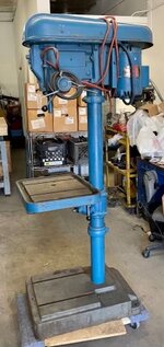

Wow. That's a lot of useful information, combined with years of your personal experience. Thank you every one and all.
I actually purchased an ugly blue paint slathered on 1982 Rockwell 17" drill press from the guy that was also selling the South Bend.
I'm right in the middle of a resto on the drill press, just pulled the quill apart this afternoon, needs bearings etc.
I've been a cameraman in the motion picture industry for over 35 years, and have always been in awe of the precision machinists involved with making everything from complicated camera movements to entire lenses to one of special projects required for shooting everything from MIB 3 to Fast and Furious 9. The pictured lathe was something I had not seen before, a lathe on top of a purpose built desk/work table. I'm not in the market for a lathe right now, but posted the pictures in case the said lathe was of interest to anyone else.
It's located in Los Angeles, and I would be willing to a assist if anyone is interested.
L
Luntz
Jul 13, 2020
213
Franklin TN
It's a shame what they done to it. Gonna make her shine again.
