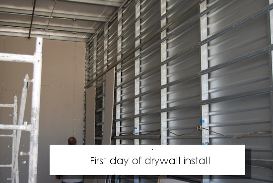

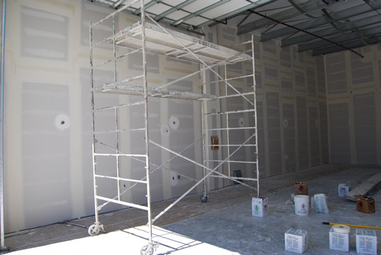

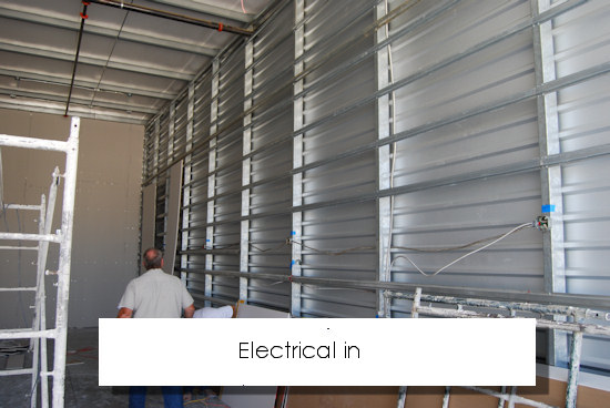

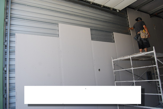

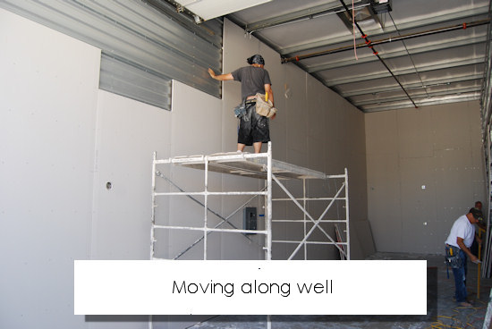

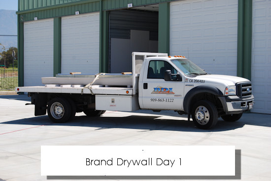

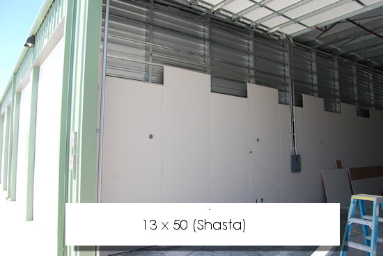

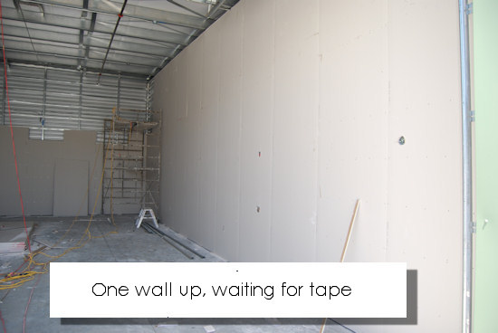

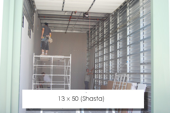

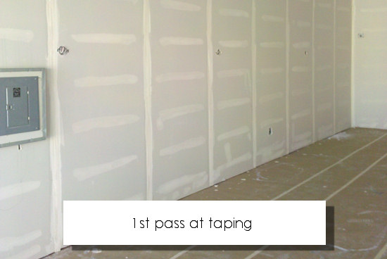

Here are some progress pictures of what we are calling "Garage Mahal".
Background - This is a garage condominium project located in Beaumont Cal, near Palm Springs. We have 107 of these garages on 4.5 acres. All are sized to fit RV's with 14' tall doorways. Sizes range from 11' wide x 38' deep, up to 27' wide x 100' deep. All of the buildings are metal framed, with interior heights of 18' at the rear and 16' at the front.
We are decking out two garages, a 13' x 50', and a 27' x 50'. We will be installing Swisstrax flooring, Gladiator Premium cabinets, and assorted lighting, paint schemes, and some garage artwork, yet to be determined.
The build should take about three weeks. Here are some pictures of our progress. We started on June 20th, 2011. I will update every few days as I have time. We are starting with drywall. I didn't get any pictures of the electrical install, as I was out of town when they did it.
Enjoy!
On Wednesday, the ceilings will be painted flat black, and the walls will be light grey, with a 4' band of darker grey on the bottom, with a gloss black chair rail dividing the two colors.

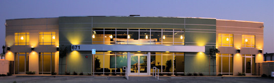

The above mentioned article is what inspired me to build out a few upscale garages. While the front of our property is really nice,
and we also have a 2700 sq ft clubhouse, the interior of the garages were pretty plain and ugly. I think the consumer was expecting more once the garage doors are opened. Now, or at the very least, soon, we will be able to show off what can really be done with these with a little imagination.

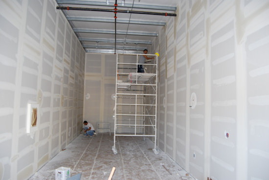

6-29 Update
Today, the ceilings are being painted flat black. This is to more or less make the ceilings (not very attractive) less noticeable, even though the ceiling height is 18'.
The wall colors go on tomorrow, with light grey on the top portion of the walls, with a darker grey band 4' off of the floor. The back wall will be dark grey top to bottom. Gladiator cabinets will be delivered tomorrow, that will go against the back wall. The cabinets are light grey and dark grey like the walls.
As a divider between the two wall colors, I am thinking about putting a "Racing Stripe" along the 4' color divider on the side walls.
Once the walls are finished being painted, I will then install the Swisstrax Flooring. I choose Swisstrax over RaceDeck due to the compressive strength (5200 psi), as we mainly have huge RV's running over the flooring. I needed something really strong. Further, Swisstrax is located in Indio, not far from us, so delivery is next day.
We also will be installing ceiling fans, (6, 2 in the smaller garage and 4 in the larger) and wall sconces (8 in each garage), and 5 drop lights, 16' nickel finish).
I will post more photos on Thursday, once I get back to the project.

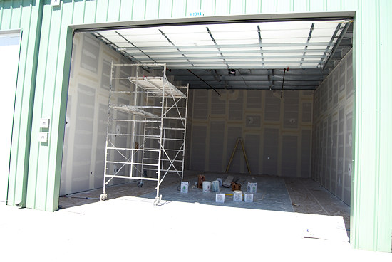

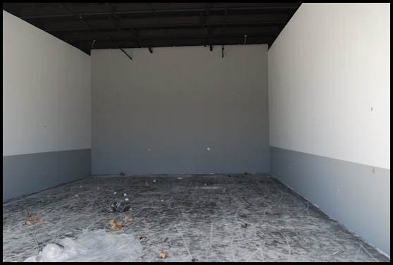

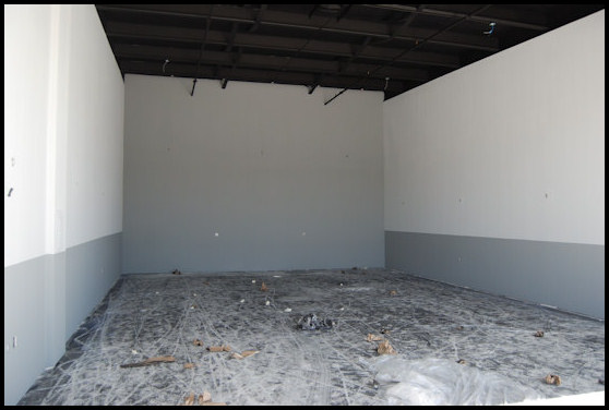

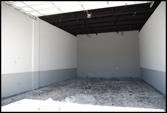

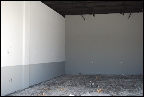

Re: Southern Cal Garage Condo Build Update 6-30
Below are pictures of our build out of a 27' wide by 50' deep garage condo.
The painting has been completed. We used flat black on the ceiling to make it "disappear". Previously, the ceiling was raw metal, with white insulation. It was not very attractive. No clean up has been done yet. The 13 x 50 garage is being painted right now, so no pics of that one yet.
Yet to come-
Wall sconces
Racing stripes
Ceiling fans
Drop Lighting
Gladiator cabinets
Swiss Trax flooring.

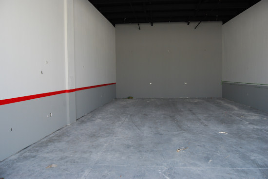

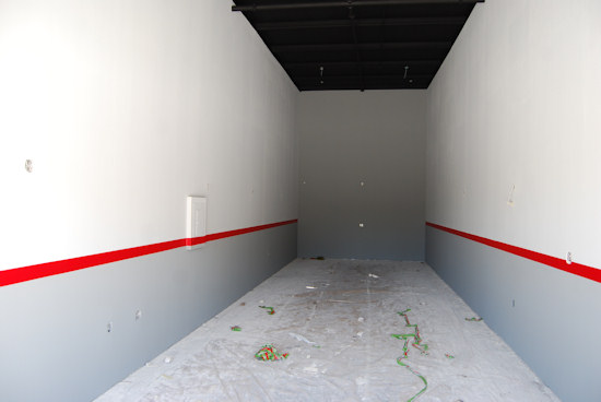

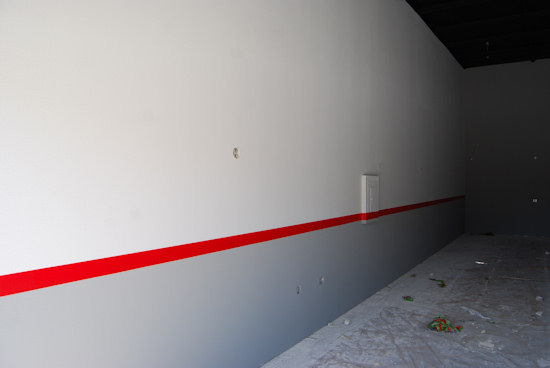

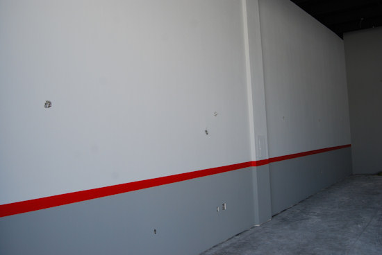

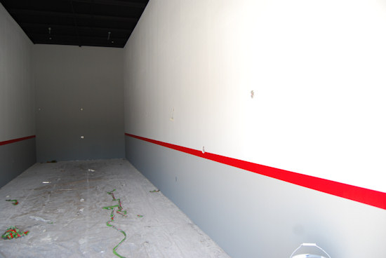

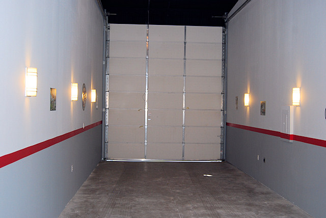

Re: Southern Cal Garage Condo Build 7-9-11 Update

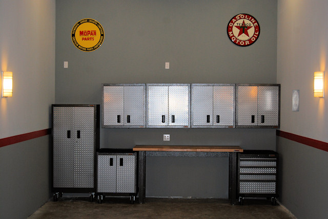

We are still plugging away at the storage condo project. The painting is finished, sans one stripe (Waiting to go to HD for more paint. Just being lazy today).
The stripes were not all that easy, since the drywall has texture and the paint tends to bleed under the tape. I used that new tape from Home Depot called Frog Tape. It advertises that it won't bleed paint under the tape. Like Hell it does. Not really much better than the blue stuff, on textured drywall anyway.
I applied the tape, rubbed it down with a plastic putty knife. Then, using the base color, I painted along the tape line, sealing the edges with the base paint color. Then after drying, I painted the stripe (red). Since there were two coats of paint on the tape seam, the first coat sealed the edges. The second coat (red) did not bleed under the tape. There was some random spots that I had to touch up, but over all, it came our razor sharp.
The ceilings in each garage have been painted flat black. That was a real mess to do. More on that journey later.
The cabinets arrived last week, and the lighting fixtures and signs are trickling in. No one has decent stock. Sign of the times I guess.
Here are a few raw photos of each of the garages.

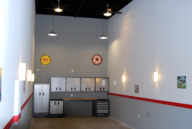

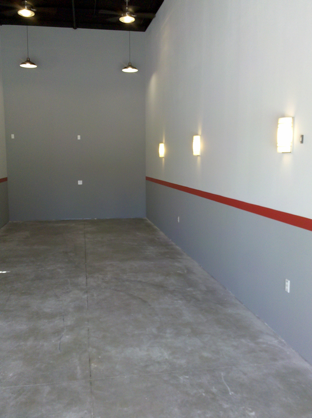

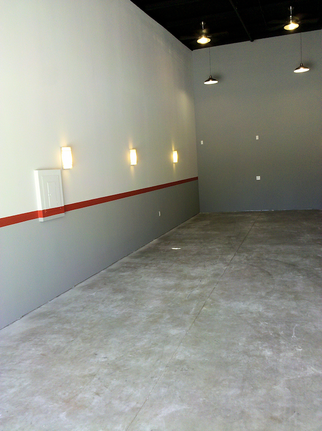

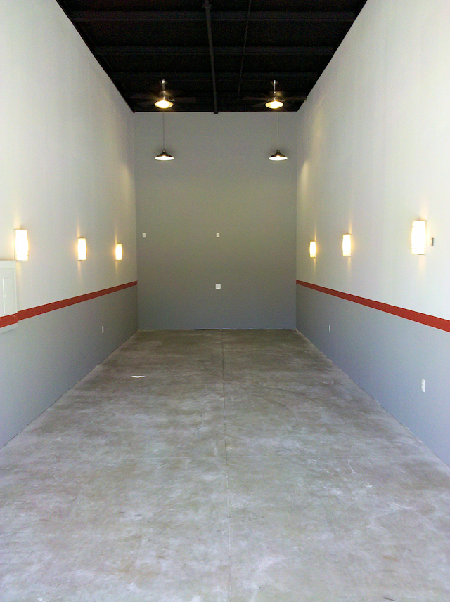

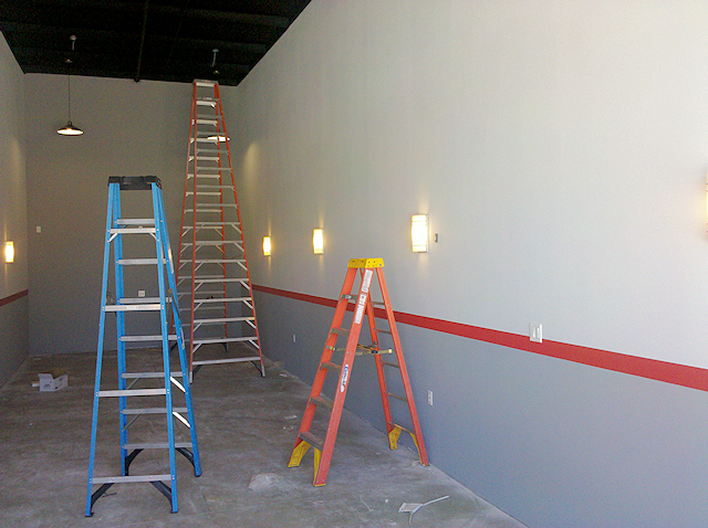

Update 7-21/11
The electricians are here installing the wall sconces, ceiling fans and various other electrical goodies. The pictures below are of the 13 x 50 garage. The 27 x 50 garage pictures will be loaded tomorrow. Next major step is Swiss Trax flooring and the Gladiator cabinets. (Sorry, cell phone pictures).

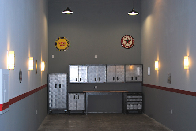

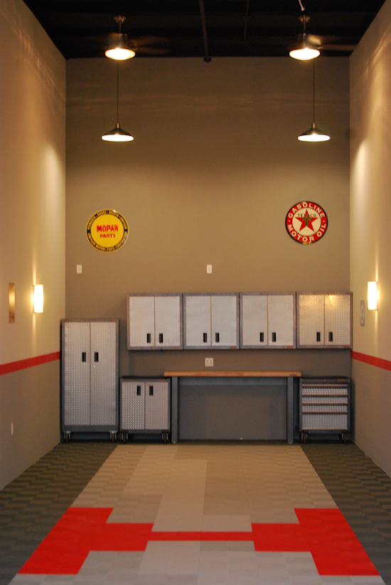

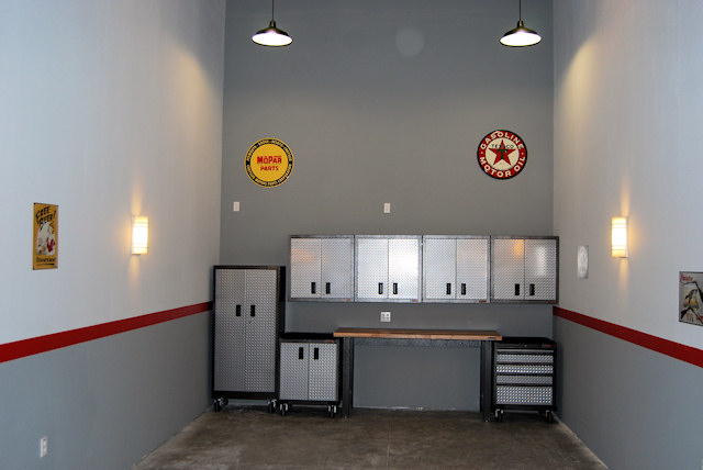

Looks really nice! Is the workbench high or the cabinets a little low, or am I missing something all together?

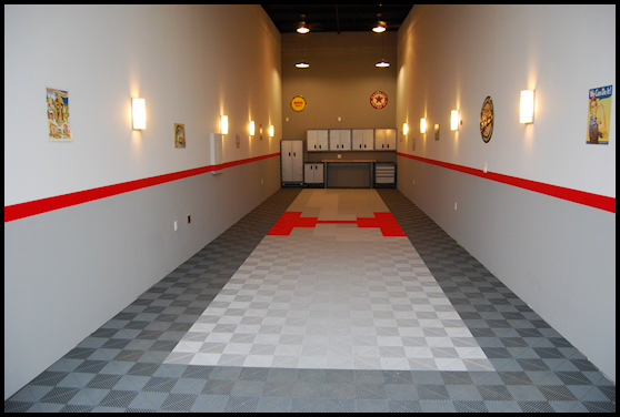

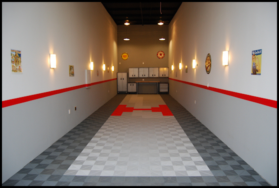

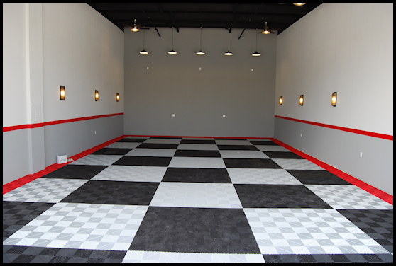

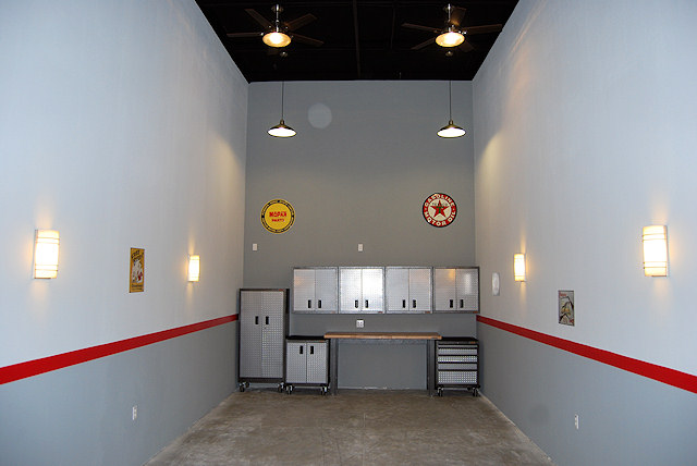

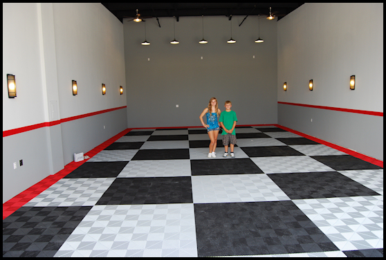

Update Sunday 7-31-11
Finished the 13 x 50 unit. Swiss Trax flooring installed, cabinets, lighting etc. The flooring looks like there are stripes in the flooring. The naked eye can't see it, but for some reason, the flash makes it look a little strange.
