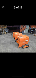

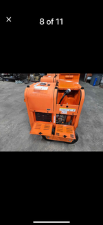

Anyone here ever heard of American Fab generators? Amfabsc.com. Not a ton of info online about them but apparently made in U.S. I have an opportunity to buy one and wanted to ask here.

Yes this is something I’ve also considered. I’ve got plenty of gas and rotate it regularly already but I also do that with diesel as well. If I can score a diesel gen at good price like that I may go that route now that you’ve got me thinking about it. My days of chasing used machinery such as mills and lathes and all the machine shop stuff are kind of over but maybe I could make an exception to find a light pole at auction or find one locally. Come to think of it, every time I pass one on the road sitting there running for days, I want one in a bad way. I was only considering the Honda 5k-6500’s because I have one on hand and can easily score another but I’ll def look into the diesel. I honestly didn’t realize they were that much more fuel efficient. I figured they were at least 6gal a night at best.
All good. I'll drop a few pics of it when I get home. I can see not wanting the whole trailer thing, even though it is small, same size as the tiny Harbor Freight trailer. My initial plan was to just harvest the power pack out of it to mount on a shelf in the garage with the exhaust going through the wall. But then after seeing how compact it was all put together, the large fuel tank being part of it, and already being portable on a trailer, I left it.
They are totally efficient and quiet. A gasoline unit can't compare. I used to run Honda gensets only, for the quality and that a genuine Honda generator (not just Honda powered) has a generator-specific large volume muffler to drop the noise more, vs a Honda powered genset of another maker will typically use the utility muffler that the Honda utility engines comes with, which is 1/3 the size.
We used to be considerate to neighbors and shut the Honda off at midnight, then restart it the next morning. Now with the diesel, nobody even knows it is running and we don't shut it off at night. They just keep saying they think the power is back on because our house is quietly lit up. We are not even in a hurry to monitor if utility power has been restored, the diesel runs the entire house without having to be careful of loads and she'll go for longer than a week before refueling.....all for $1,000.
I still buy, service, and resell good clean Honda units as a hobby for half the price of new ones, but I don't personally use them anymore. Only advice on any off-brand generators like from Costco, etc, is to make sure parts are available, and not just spark plugs and oil filters. Things like valve cover gaskets, governor springs, voltage regulators, etc.........
