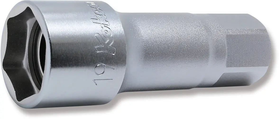

I was looking at this just the other day. I was surprised they don’t make a 19mm (3/4”) clip spark plug socket. Was wanting a set and outdoor power equipment uses 19mm a lot. where are you folks buying your koken here in the US?
Depends on the sale. Ko-Ken had a 20 or 25% sale for SEMA or Black Friday, can't remember which, and that was a decent deal. Zoro does not seem to have linear pricing among KoKen products so some outliers can be cheaper there with a 20% off coupon, but not everything.
Koken seems to mostly focus on what's common in Japan, so it's not surprising there's no 3/4 plug socket as I guess that's a US OPE thing. And they've really had no presence in the US until the last few years.
I've purchased most of my Koken from Palmac. DRPD is now another good source. There is also a Koken USA website, but it seems to be related to Palmac and is typically much more expensive. But they do have a few items that Palmac doesn't, or at least they did for me; for whatever reason.
Not clip style but magnetic, and seems to be well made compared to others that use a really thin "washer" style magnet (see drawing detail of magnet ring that holds the body of the plug rather than the edge of the hex).
3/4 plugs on some Japanese Honda or Kawasaki small engines, cant remember which right off. I work on both and keep a socket on hand. Also some Suzuki generators and common on Stihl.
I too am surprised Koken doesnt offer this size in a spring clip version.
