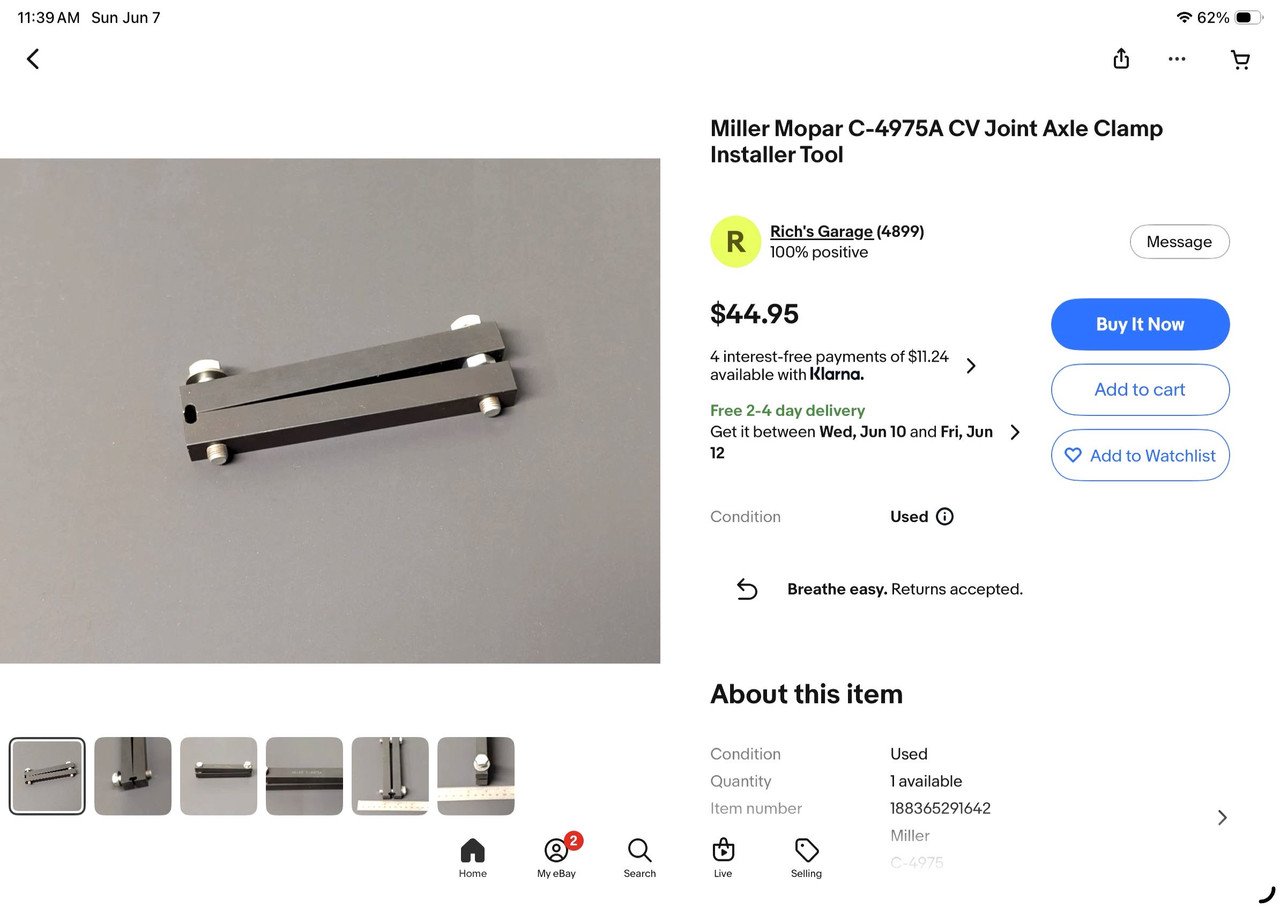

I found that the tools called out in the factory manual work best, and sometimes find them for low prices on eBay.
I bought the miller special tool called our for my Jeep and it is easy to use and works perfect every time.
This video link starts where I start using the tool.
I bought mine used on eBay years ago for about $35. I just looked and there is one on eBay for $44.
I assume this tool will work in your Honda, but you can check.
