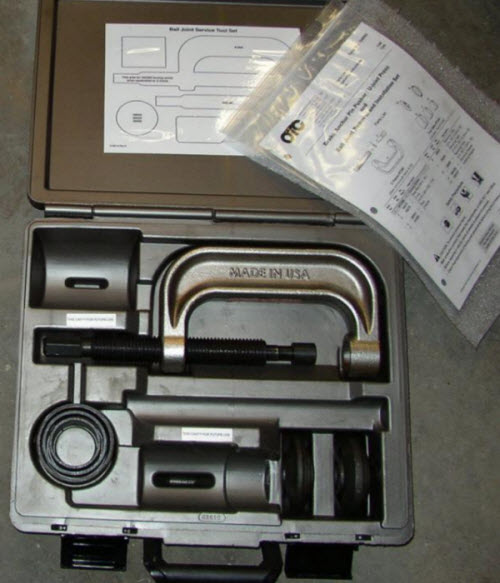

I bought the OTC set a few months ago. The press is made in the USA and prominently labeled so. It is a good HD set at a very competitive price. You can't go wrong with it.
Thank you. Can you compare it to OEMTools at all? The trade between OTC and OEM is my main query, so I hope you can add some input.

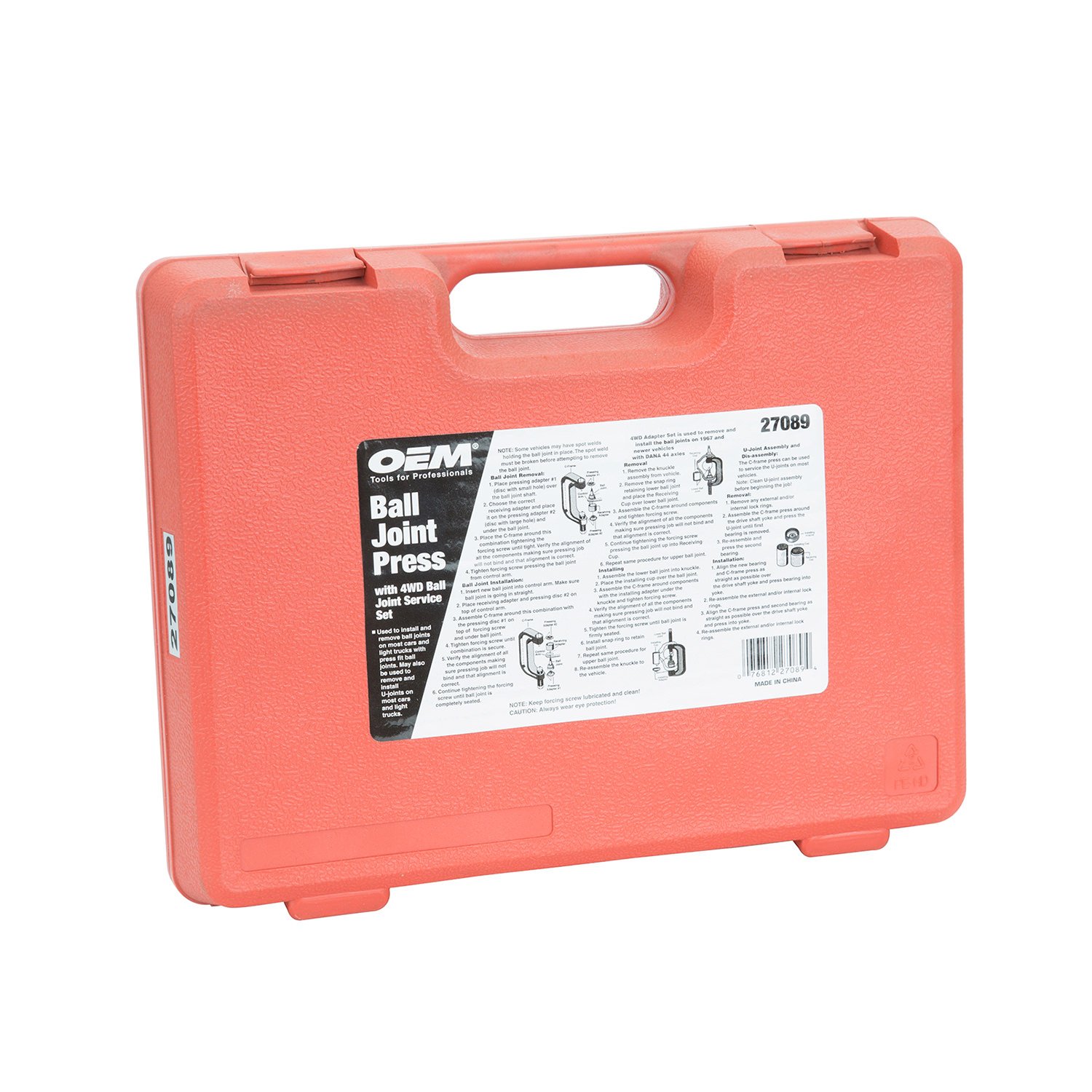

OEMTools is a division of Great Neck Saw. They make pretty good mechanics tools overall. However, some things are made better than others so, you really have to try it out to see how well it's made. Often, many auto parts stores use OEM tools in their loan a tool program. If that doesn't kill them nothing will. :lol:

I own a ton of OTC stuff and am very happy with it. All of it is USA made (except for my tie rod puller kit) but some is old. The only dealing I had with their customer service under Bosch was to request replacement manuals and they were excellent in providing them. So I will continue to purchase OTC. But as mentioned, do NOT buy their Stinger junk.

It is true that the OTC 7249 Ball Joint Press was made outside the US for a brief period (circa 2013/2014?) when a lot of the rest of their product line also started moving that direction, but has been back to 'Made in USA' ever since. I'd be really surprised if any place that sells very many of them still had any of the offshore ones in stock. IMHO it's a great press. The same exact press set also sells rebadged as the Matco BJP7025C and as the Mac BJ7025MA (and as pointed out by thwaller, can be bought through Snap-on too. That was news to me) for about twice the price.

IF COO matters to you, the OEMTools 27089 is made in China as is the Astro 7865.

The OTC has only added back the US made press frame the other parts are imports and Astro has added a stronger Press frame in the last time a couple years ago. OEM is just a generic tool importer as stated above from Great Neck line of tools. I have OTC and Astro and use which ever tool fits the best have not had trouble with any of them and please lube the screw with oil or ep lube of some type.
