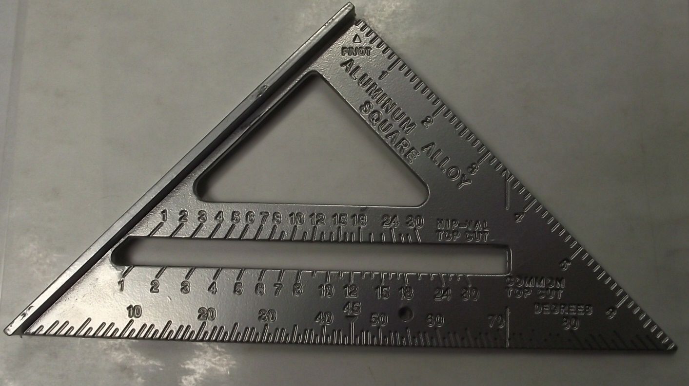

Maybe it's the way the image comes across, but in the first pic, it looks like the bottom blade of the digital isn't quite touching the square - such that the digital WOULD be reading less than 90 degrees.
You are absolutely right. It isn't quite touching the edge of the square. At least not along the entire length. That's because there is a defect in the square that won't allow a truly square edge to sit flush against it along its entire length.
I made a quick video to show what I'm talking about.
Also, @PCustoms , I acknowledge the protractor isn't a super expensive precision tool, but it's very good for what it is, and there's no chance it's out by a full degree. See the video.

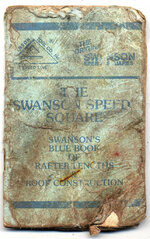

Big Swanson, little Johnson (poor fella), little no-label. Big Swanson was chipped on a fall to the concrete floor.
Funny thing is, I've never used any of these for rafter cutting or angle measurements of any kind. Wouldn't even know how to use them for those reasons, though I still have the original blue manual that came with the Swanson.
Stand the speed square on its flat edge and use a feeler guage to see if there is a gap under one side as opposed to the other. If so, you somehow dropped it or crunched it and bowed the aluminum flange on that side. Its not a torque wrench so it isnt typically handled like one, and accidents happen.
