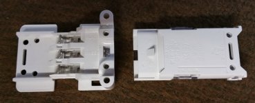

I have used the TE Connectivity Tap Kit - works great. Lowes has it for $7

I need to see that in person. Trying to figure out how you add a line to it from the picture. Looks like a great solution though.

It is actually two pieces
On the main piece (the tap of the through line) you strip off a section of the outer jacket and the individual wires get pressed into metal teeth. Then you snap on the clear plastic cover that locks everything in place. The metal teeth extend in the plastic body and form a connecting point where the second wire then plugs into the main body using a similar type of connector
These connectors are only to be used for REPAIR wiring - they are not approved for new construction (walls open kind of thing)
This pic shows the main romex cable being tapped
This pic shows the second cable where it connects under the main cable

Now I see it!! Thanks for the pics!!
