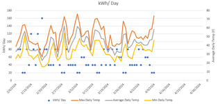

So have an update on Geothermal electric usage... long story short, changing the setting didn't really address the issue. I've been tracking daily meter readings relative to temperature, and have used 1400 kWh so far this month (average of 73.7 kWh/ day). Daily high was 160 kWh in a 24 hour period between readings on the coldest day/ night combo over the last 3 weeks.
Temp dropped below 30F this last weekend, and I can see that the unit stages from Stage 1 to Stage 2 to Resistive Heat below 30F. It is using geo and resistive heat when below 30F instead of just resistive heat, so I guess they fixed a small issue.
Both today and yesterday, I've been manually tracking data while WFH, and noticed a few different trends.
1.) HVAC stages every 3 minutes until Leaving Air temp (LAT) hits 88 deg F. (Confirmed the 88 deg F in the arzel zone controller settings).
- So every time unit has kicked on since Heat was enabled in October, it has run 3 min in Stage 1-> If LAT temp not met/ Temp request not met then stages up to stage 2, runs 3 minutes, and if it doesn't hit 88 LAT and satisfy temp request, then it kicks on Resistive heat (when below 30 deg F outside.)
*I think this is the majority of the problem
2.) Unit seems to cycle on and off frequently. I tracked it yesterday for an hour, and got the chart below... If it was kicking up to stage 2 heat or resistive heat (not shown, but implied) then that makes sense why the unit only runs for 5-8 minutes every time before the zone is satisified, and then kicks off for a short time. Thermostats are set to 5 Cycles per hour (default settings, only changeable in technician access), which matches what graph below shows. I'm assuming changing CPH to 2 or 3 will make the unit run less often, but my gut tells me based on the LAT stage up settings, it will still only run for 6-10 minutes each time since it will get to stage 2 heat after 3 minutes and be satisfied.
*I think this is compounding problem above...
Have HVAC company coming back out Thursday morning, so hoping they will get things setup correctly this time. I've been shoving data at them hoping they will come and make this right (I've essentially spoon fed them the root cause while spending my time taking data and telling them what is happening). The root of all of this seems to be zone controller setup, and not even the geo operation, which I guess is more frustrating since any HVAC company should know how to setup a zone controller. This one just happens to be running a geo unit vs. fossil fuel unit.
I'll report back after a week or so hopefully with lower daily kWh usage. If its fixed, then I need to figure out if I go after them for high bills the last 4 months since they did a crummy job setting it up in the first place.

Are you saying it runs resistive heat and geo at the same time?
The way my system is setup (now), is that it looks at Leaving Air Temperature (LAT) and Outside Air Temperature (OAT). I have an Arzel GTPro 3 zone control board. Stage Timers are turned off, and OAT Balance point is now turned off.
What that means is that for Oct, Nov, Dec, and part of January, when OAT Balance point was turned ON and set to 32F, anytime it was below 32 F, it would lock out the compressor and run backup Heat (W1 Call) only, and not run the compressor.
Now that I have the OAT Balance point turned to OFF, and we just lowered the OAT Balance point temp setting to 25F, if it is below 25F, then the Arzel board will run stage 1 compressor (Y1) for 3 minutes, check LAT, and if it did not satisfy the LAT of 88F, then it would stage up to Stage 2 compressor (Y2), run for 3 minutes, check LAT for 88F, and if not satisfied, it would stage up to resistive heat (W1) and run both compressor and resistive heat until call is met.
-Above 25F, it does the above, but W1 is locked out.
HVAC tech called Arzel tech support while he was here last week, and confirmed that the 3 minute stage up is hardwired into the arzel board, so nothing I can do to change that.
- We did change the LAT stage up setting to 80F, so now it will often satisfy the heat call with stage 1 (Y1) setting, but with OAT hovering around 40, Stage 2 (Y2) still kicks on a lot from what I have watched on the board. It also stays in higher stage once its there (it will not stage back down to Y1 if LAT temp is met is Y2). If another zone starts a call while the first zone is satisfied, e.g if Zone 2 is calling for heat, and bumps to Y2, then Zone 3 calls, Zone 3 will stay in Stage 2 (Y2) for as long as it is calling, even though LAT is well above 80F setpoint, and Zone 2 call is off.
I setup the Zone capacity stageup threshold to 65% with Zones 2 and 3 with 30% each, so technically, it should never stage up compressor if Zones 2 and 3 are both calling at the same time.
Based on the last few days of electrical meter readings, I think in general the settings changes are helping. It's honestly hard to tell though since outside temps have been fluctuating up and down so much over the last week or so. It seems like the zones are calling less frequently though, so I'm not sure if it had anything to do with the settings changes, or if its just fluctuating since its been a bit warmer out. Zones seem to get satisfied in 4-6 minutes of run time:
The Trane XL824 thermostats are potentially part of the problem, but I don't know that for sure yet. They run a PI control scheme to determine when to call, and I haven't figured out yet if they are maybe causing some of the issues with short run time and frequent calls.

Hot water tank is connected in series from geo to HW tank to Gas Tankless HW Heater. The HW tank is not plugged into wall (basically just an insulated reservoir, and Gas tankless heats water if demand/ temps call for it.
In general, I think the problems are mostly resolved after having to hound HVAC company for the last 4+ months about incorrect settings on the Arzel zone board. I've been tracking daily usage manually looking at the meter, and logging daily temps for the last 2 months. In general, I think the issues are mainly resolved, but I'm sure there is more room for optimization. For April, I have bumped up all thermostats to 70F vs. setpoint of 68F to see if there is quantifiable difference, but with temps going up, it won't be very scientific.
I'm still chasing Z3 higher runtimes vs. other zones, but have some remodeling to do and will check insulation on that zone while I'm at it this spring/ summer.
I point blank asked the HVAC company how they were planning to compensate me for the 100+ hours of monitoring and $1000+ higher utility bills after they finally "fixed" the issue by changing the arzel zone board settings. The response I got was "this is the normal way for the geo is to be set up and we have done this many times without complaint", and an offer to extend my service agreement by an additional year. At this point, I'm chalking up the higher bills to part of the install cost, and payback is going to be delayed by 1-2 years due to their incorrect setups. Hoping with the coming summer months I get a bit of relief on cooling costs.
