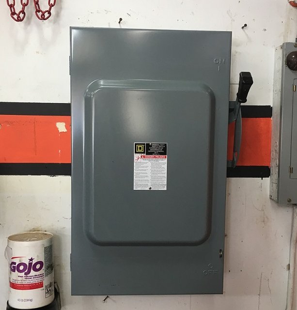

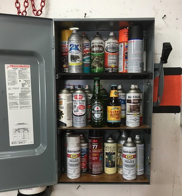

I like the cheap shallow cabinet from HF. It isn't the best quality but it works great for my needs. 3 doors, and locks if you care to use them.
https://www.harborfreight.com/hanging-tool-cabinet-39213.html?_br_psugg_q=cabinet
pcmeiners
Aug 13, 2009
7,952
"Cool incognito cabinet Ichabod. You could hide your valuables in there and hopefully burglars would never suspect."
Agree, both ideas pretty cool.
