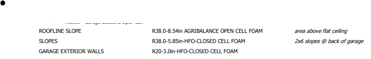

I've searched through some threads but still not sure about my garage situation. I have a one-car attached garage with no insulation currently. Looking to get spray foam on the exterior walls and roof. Probably will go with closed cell on the walls and open for the roof (see below from the quote I was given), but curious about a few things:
- I see a hot debate on open vs. closed for roof i.e. that closed will not allow any water leak to permeate, thus could cause mold/rot and you wouldn't be any the wiser, whereas open is water permeable. Given the lack of consensus, I'm inclined to go with open cell on the roof.
- I have a ridge vent currently, but no soffit vent. Do I need to consider adding soffit venting? Or maybe that would be useless. When they spray foam, I would think this eliminates any venting for either soffit or ridge since they are covering over it, unless I'm missing something. I just don't want to have any issues with trapped moisture in a very well-sealed garage.
- Is it going to be a pain in the *** to run any new circuits from the breaker box, since they will spraying all around it? Not sure if there's any tips here to consider.
- Anything else I should be thinking of? I plan to use the garage space for cold plunge tub, future sauna, some minor repair work, and cooking some steaks, etc. (with the door and window open). I will also be replacing the garage door with a nice insulated door. I'm located outside of Boston. I also have the boiler and oil tank out there.
