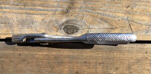

This was a left-behind this morning at the Quakertown Flea. I think it must be very early, with the raised “BONNEY” on the dynamic and nonremoveable main screw. The handle
looks right for early, but I’ve usually seen the squared-off rail only on their farmer/garage vises, not clamp-on table vises.
Though the vendor suggested he could come down in price, I didn’t think we would really come to a satisfactory number. Plus, I probably have dupes of this size.

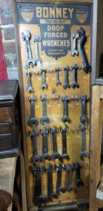

Happy to find this early embedded Princeton shield BON{/}NEY logo 1723-A DOE wrench at the flea this morning, which is perfect for my board. There's one on it now, but the more the merrier where merchandising boards are concerned.

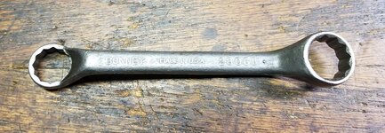

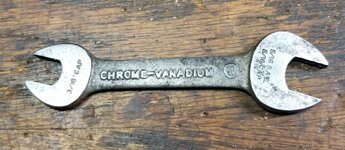

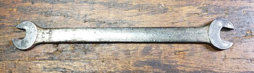

Plucked another early ("FR"=1926) BON[/]NEY logo (CV) wrench out of an old box this morning at the flea. P/N "8877" with 3/8" x 1/2" service openings. I have never seen this one before and I don't have any with the same numbering scheme, which is pretty much the only reason I brought it home. As I was saying on the GS thread, it's not an engineers' wrench, but not a tappet wrench, either, despite its wide, thin, unusually lengthy shank. Seems brake-y, but again, I don't recognize the number. I will have to hunt around in some catalogs, unless @LesserSon or someone else knows.

I cannot find that "8877" wrench in any catalog. There are similar so-called "Long Engineers' Wrenches" in their late 20's to 30's brake service sections, but none with these service openings or "8xxx" P/N scheme. It also resembles some of their aircraft service wrenches from the same era and they did have high numeric P/N schemes, but mainly "7xxx." I'm stumped.

I looked in the 1926 and 1932 catalogs and, same as you Lugz, I have not seen that part number. Too bad we don’t have a 1927 or 1928 catalog.
I agree with your observations, maybe a special brake or aircraft wrench. If so, the part number may have been made up just for a special order.
What’s the overall length? Despite being (apparently) unique, it probably has a die family. The Long Engineers are supposed to be 15” or 16”. To me it has a 420 Series look, so should be 8”-9-1/2”.
30,872
Good thought. Here's a photo with a few 420 series tappet wrenches. Similar in OAL, as you surmised, but the shank of the 8877 has more girth. For an appreciation of just how different it is from its ISN equivalent engineers wrench, that DOE above it is a 723A with the same milled openings! :)

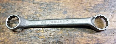

One of a 3-pc double box double offset stubby set in the WWII GMTK, found at the flea yesterday, with a 1942 ("IT") date code.

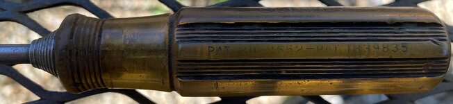

I think they are made by Ullman, and rebranded by everyone. I don’t have on myself, but here is a picture of one
