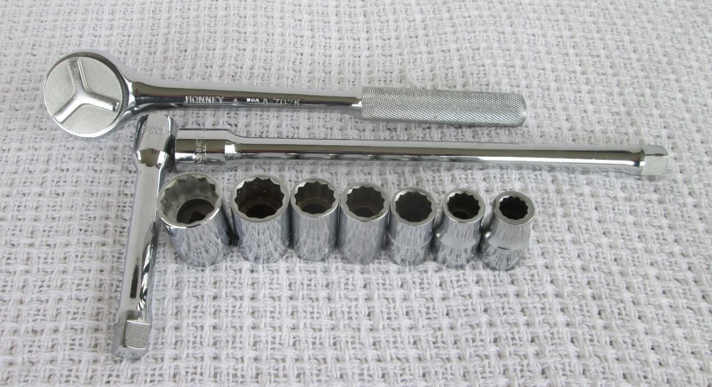

Well the second time is a charm for having a 3/8ths ratchet and this showed up in the mail today.

Holy Bonney, that TD set in the box is gorgeous! I'm not sure how the decal got so beat up when the tools are practically unused, but that's a quibble. That set is fantastic. (EDIT: While the seller has a 1934 catalog, which he used to date the set to early 1930's, he apparently doesn't understand Bonney date codes. Looks like all the pieces in the set were made in 1929 to me.) I don't think the box would go for that much by itself, but the second sale does show how important an original box is to a sense of a set's completeness.
B
bonneyman
Apr 22, 2010
8,857
Desert SW
:shocking::shocking: Damn the chrome on those items is outstanding!
Judging from the tri-wing selector on the ratchet - and the non-Loc Rite sockets - I'd say the set is from the late 60's. (That's if the tools pictured are all from one set originally).
Bonney intro'd that style of -702K ratchet in 1967, and didn't change the selector knob to a single ridge until 1980-ish. I don't have a Bonney catalog in the early 70's, so, I don't know when their sockets got the Loc-Rite broaching. But those look like earlier, pre-Triangle Tools broaching, and I think that TT pushed out all the old inventory early on (after acquiring Bonney) before offering new stock. Hence my guess for late 60's.

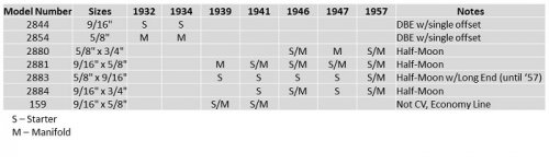

30,819
So I guess Bonney made the entire size range in half moon wrenches.
I'll have more to say about this tomorrow when I'm with my notes. If I had to provide a one-word preview to summarize their early production now, it would be "Squirrely!"
...completing a set of CV I've been building for two years. I believe the date codes stretch from 1928 to 1931;
That is truly impressive, LS! And I agree with your logic.

I don’t recognize the 26XX, 27XX, or 29XX series part numbers you guys cited in these posts, so I am guessing they must be from the 60's or later. What is the date on the catalogs you are talking about seeing these part numbers in?
If you don't know, I am a Bonney guy, mainly from the 1920's through the 1940's. I also collect half-moon wrenches. No real affinity for them or anything. There's a pair of them (5/8 x 3/4, and 9/16 x 5/8) in a couple of WWII rear echelon maintenance depot tool-sets, so I started picking them up at flea markets. I found a Barcalo, then a Duro, etc etc, and it just sort of took off from there. Anytime I see a brand I don't yet have at a flea market, if it's wartime vintage, I pick it up. I'm trying to avoid dupes.
Ironically, I haven't found a Bonney yet. But I did put a chart together to help me figure out what to look for (see thumbnail below), which as you can see by the chart, wasn't easy when leafing through the older catalogs. I already called it squirrely. Let's just say it wasn't consistent.
Early on, Bonney made separate wrenches for starters and manifolds, and they weren't half-moon pattern, they were single or DBE's with offsets. Then they combined them in a half-moon pattern, one for manifolds (2881) and one for starters (2883). But the 2883 starter wrench wasn't really a half moon. It has one extra long end, if you can picture that. Until 1957, when they made a 2880, 2881, 2883, and 2884, and called them all starter and manifold wrenches, the catalogs are all over the place in terminology.
Probably way more than you needed to know - especially because you guys appear to be collecting later Bonney, but I had it on hand, so there ya go.

LesserSon, that's a very nice set of wrenches!
The box should look something like the one posted by u/linwood posted HERE in the DBE thread. :drool:
Yeah, I remember those. I think Twertsy bought/posted a complete set somewhere along this thread, too.
Lugz, that’s a nice piece of cross referencing on those squirrely *** wrenches;)
