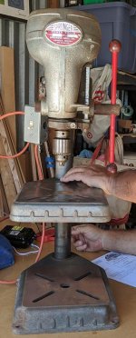

I have one of these that I just purchased, It has an old belt on it, that I think is the wrong size.
What size V belt did you purchase to replace yours?
Thank you
Aikiguy
Apr 30, 2021
2
CA
This is my new to me old drill press....
Thanks
