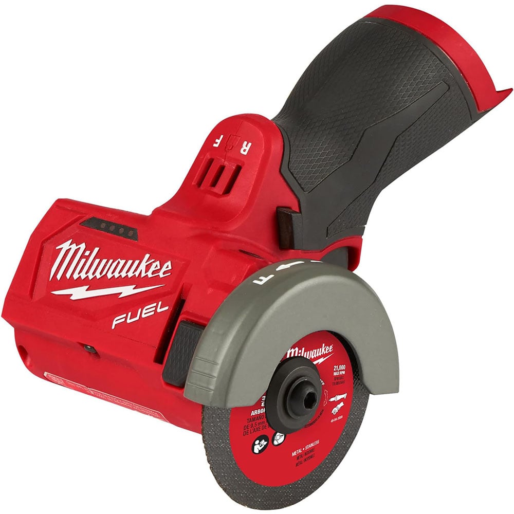

Not exactly the same situation, but close. I've screwed 4X4 blank plates to the tops of panels where the knockouts were torn up and punched my holes in the blanks. .
4X4 covers extend beyond the depth of a standard panel. Cut them off with a bandsaw, sawzall, or heaven forbid hacksaw (They need to be cut from both sides because the plate is wider than the throat of the hacksaw)
It was a panelboard that some jackwad that wasn't me installed with the factory knockouts on top. I always put the ko's down so there are no knockouts on top. I'll punch my own holes where I want them.
If it were a loadcenter I think I'd break out my M12 cut off tool and if I didn't have one, it would be a good reason to buy one. :thumbup:
