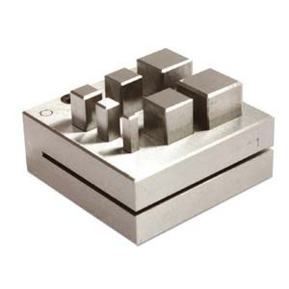

What is the best technique to make square holes in sheet metal?
I need to make square holes that is 8,95mm x 8,95mm. Its for plastic grommets.

Sounds like you need to make something like this specifically for your size requirements.

Yes something like that would be ideal. Do you think it would be possible to make one strong enough for such small holes?

How thick is the sheet metal? The hole you need is rather small so it would take a small bolt for the cutter but I imagine it would work.
Also, I have used round hole punches like the square ones below on roofing tin before so these may work on your application but the only drawback is it will stretch the surrounding metal and can cause deformities.

A punch is the way to go.
Roper whitney makes good stuff. I have their 5 ton hand punch. It's round dies only, but it works great.

http://www.sterlingmachinery.com/manufacturer.php?brand=Wiedemann
These are hand operated punches that you can swap in all sorts of different shaped punches. They are the small version of turret punches that are used for CNC sheet metal fabrication. Browse ebay for replacement punch options....
Not sure, but you may be able to buy just the square punch and then set it up in an arbor press.
also look at the punches used in the electrical trades industries. I bought a small hydraulic punch set from ebay for about $125 for a variety of round dies. You may be able to get a square punch to work with this..... It made punching through sheet metal quite easy...
Of course, the other way is to get a sheet metal shop to punch it for you or to have it laser cut.....

Drill hole in A2 tool steel flat bar. File square. Mount in arbor press bed. Use round A2 tool steel rod to fit upper mount in arbor press. File to square shape. Fit into press to check fit and alignments to each other. Remove and heat each piece glowing red with flame torch. Let cool in air. Grind end of punch flat. Reinstall and use. Tools needed, drill, file, torch. Someone will tell that it has to be annealed, but I use this method regularly and see no need to anneal with the A2 and flame technique for low use tooling. In fact, I do this in a high use spline broach for both brass and steel. .040 may take a decent pull to penetrate using a smaller press. A slide hammer can be attached to the upper ram of the press to provide "persuasion" during punching. An arm can be mounted near the base plate to act as a stripper to get the punch out of the hole during retraction.
