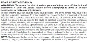

just to clarify, the fence to blade is square on one side but not on the other? so the base has nothing to do with it right?
manual says to adjust the two fences, they are 2 pieces, not one, right?
so is it a question of the one side needing to be flattened on a piece of granite and sandpaper?
or is the hole slightly off where it tightens with the knob?
I am just referencing the manual I pulled up:

BukitCase
Apr 11, 2017
1,075
Oregon
Gungatim, that instruction is totally different from the stated problem - those saws (I have one) have upper and lower fences. The lowers are bolted to the base with torx screws, the uppers slide in or out and lock with finger knobs.
The upper fences' inside edges (toward the blade) are angled, and for more radical cuts might need to be moved out of the way of blade travel. The instruction you posted refers to THAT adjustment, not making the entire fence true on both sides... Steve
that makes more sense. their manual was hard to understand and since I have a Makita which is different, I was trying to make sense of the OP's problem. I have used Teflon tape (used to get it from work) to shim minor variations in some of my other tools fences, but glad the OP is getting a new one!!
