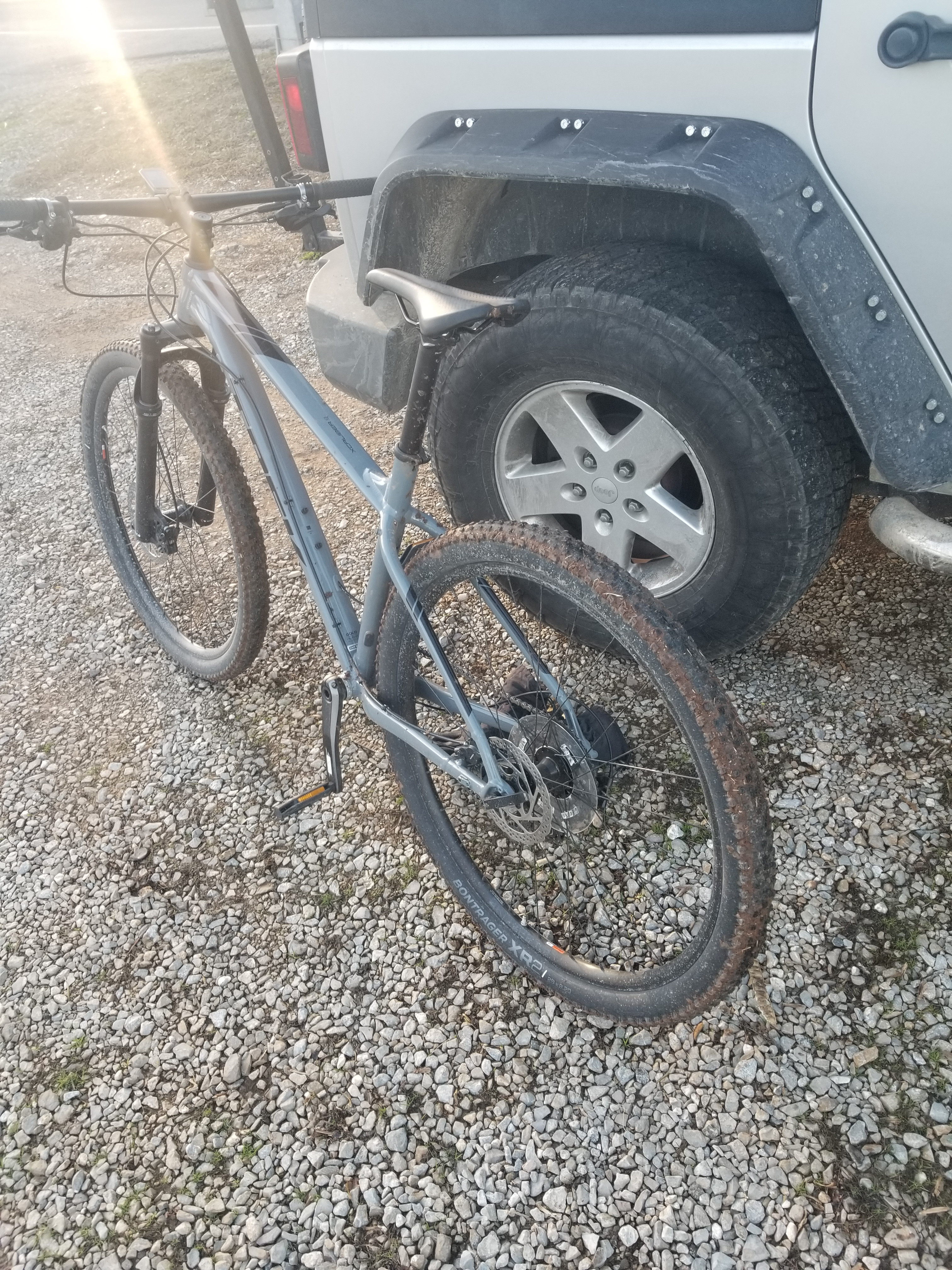

So after all the deliberation and going back and forth and general unavailability of anything around here, I may have finally lucked into adeal on a bike. A buddy has a like new trek x caliber 9 2019 model that he has ridden just a few times. I offered him a grand for it and I think hes gonna take it. Only two things I will need to do would be dropper post and a 1 by crankset. If it works out it also saves me about 650 over anything else I was looking at!

So after one ride on the trek, I came home and tore it down to remove that plastic ring behind the cassette, pulled chain off for a dip in my special wax, and replaced the pedals with a new set of platforms since the plastic ones were scary on the trail. Reassembled the cassette after removing that spoke guard ring and now my freehub sound like a wheel bearing has gone out on a trailer. The noise coming from it is awful but only when it freewheels. Bike is brand new, the bearings are smooth, could it have a stuck pawl?

Xti, I was excited to hear about the X Caliber... Then, that sound must be just something stupid. Do some investigating. Lube? Something? Keep us in the loop.

Well tore it down pulled freehub and then took it to the local trek dealer. He listened to it and said "its a cheap bike and I cant guarantee that a new one wont sound like that" . So I brought it home reassembled it all and rode it. Does fine just so noisy compared to my gravel bike. The chain helps dampen the vibration some, nothing visible thats wrong. So after riding it again tonight, I broke down and threw money at the problem. I ordered this to fix it.

The kobain is months out. I got the trek cheap and pretty much have it sold for a profit. The only thing that ***** is the commencal was 1499 last week. Now its 100 bucks more so I lost out by not ordering it a week ago. With the slack head angles. Its not like buying a roadie where there is not much difference. so many different styles of mtb! Im excited for it to get here. If I could figure out posting pics I would throw some up on here.

What you could do to that cheap freehub is, if it is allready back on your wheel.
Take of the cassette, take out the bearing and axle.
Then spray a good amount of wd40 on the inside, where the threads for mounting the cassette are. As you can see, there is a small gap between the housing and the sealring.
Then you spin the freehub, normally you quickly feel that it spins better.
Then you blow it with some air.
Afther that you do the same, but with some thin lubricating oil.
After that, that's the best you can get those cheap freehubs.
Kind regards, Toon

Toon, while it was apart I loaded it up with a generous amount of thin oil to try amdnget it to quieten down. Cleaned everything and made sure axles went back with a thin film of grease to make everything play nice. The effect of the lube was minimal. Still rode it anyhow. Bike rides perfect I just found the noise level to be unacceptable for a bike in that price range. I know its not a 8k full carbon bike, but my 1000 dollar giant is dead quiet compared to that thing. Anyhow its now up for sale if anybody wants a great xc bike with a noisy freehub. Will have a bike box next week and not afraid to ship it to anywhere.
