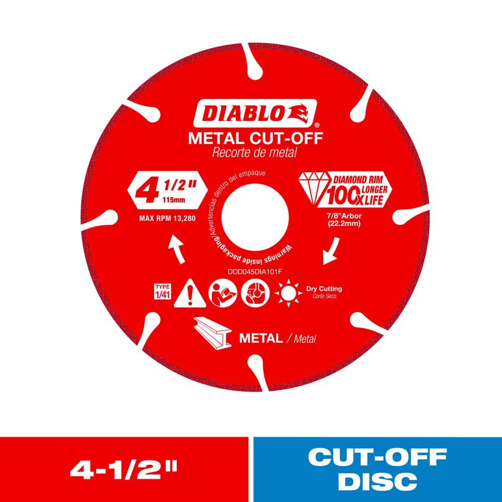

Do NOT-NOT-NOT use a cut off wheel as a grinding wheel! Use a grinding wheel or flap disk with your angle grinder. Or a bench grinder, or a file, etc. But a cut-off wheel is used for cut-off tasks ONLY, not as a grinding wheel. (not counting the sort-of advanced level use of a cut-off wheel to grind/nibble using the edge/periphery ONLY)
Wear a full-face shield AND safety glasses when using an angle grinder no matter what. Protect the eyes and face.
Wear hearing protection (muffs or plugs) when using an angle grinder. They are loud enough to cause hearing damage if you don't protect your hearing.
There ARE metal-bodied diamond-coated cut-off wheels made for use in an angle grinder. They work pretty well. A bit more expensive than the thin abrasive cut-off wheels, but they don't shatter suddenly (usually) or wear down in diameter. But they still do wear out.
