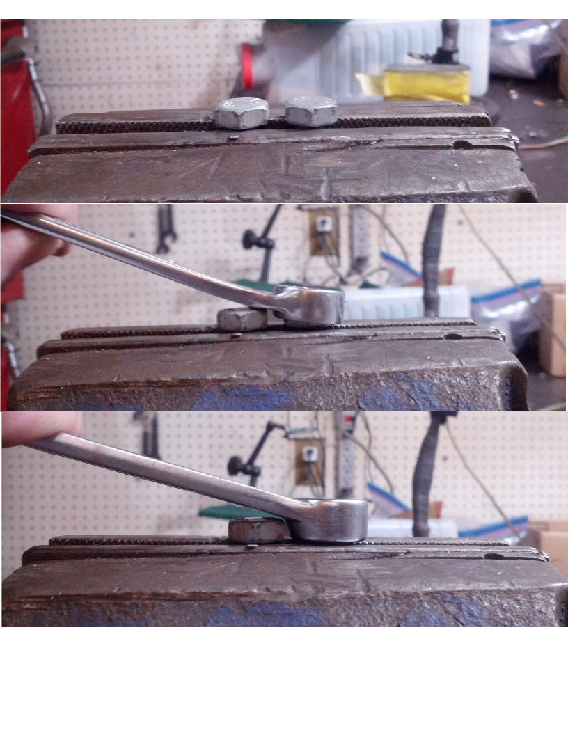

One of the biggest things I love about my Hazet 600Ns is the deeper box offset, really makes a big difference in getting on closely spaced fasteners. I would go with the 14s.
Mac KnuckleSaver 2 vs Hazet 600N, both 13mm:

That offset/clearance is something I really find useful.
I am hoping my 600Ns are the perfect mix of what I like in my DBEs and a little longer than Facom 440s. If not, I'll be ordering the 14s too.

The Stahlwille 14 have a different offset to the box end compared to the Hazet 600N and the Gedore of similar length. Are they better? Probably not, but all three are very good tools.
As mentioned previously, the Stahlwille 23 Corona double box wrenches have the same offset design and would likely be less $$ for a set if you already have set of open ends.

Glad I went with the 14s, just the right length for me, be interesting to see how much difference the stepped 10 degree box end makes compared to a normal combo??
To me it's a bigger difference than most other special "features". From beam shape to anti-slip open end features to finish to box-end wall thickness, that offset has been a bigger differentiation than all of them IMHO.
