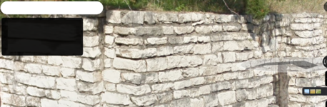

but we digress. the OPs original post about re-pointing is something I'll need to do myself (hire out for) for our property when we sell in the next couple of years. I have a 27yr-old 60ft long retaining wall of stacked stone on the street varying between 8ft to 3ft high. mortar has worn out over the years and come out. need to see about having it fixed (at least cosmetically) before putting on the market. needs a pressure wash and fresh mortar. will need to start seeing what labor prices are for that kind of work

Better start saving right now, masonary contractors are high up on the cost scale (here in Montreal anyways), the cost was prohibitive for us to hire this job out. The lowest bid was even a sting. I only had bids done to value the size of the job and the savings, because I am happy doing the work myself, it's not a chore.

I find out I'll let you know but I suspect it won't be that expensive here due to labor source. even so, the quality of work and the extent of it would probably differ from your situation.
