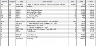

Maybe ... I attached a copy of the quote from Best Buy Metals. 26ga 16" standing seam hidden fastener panel. I saw they quote 30'3" instead of 33'. Original quote worked out to about $1.62/sqft. I do have the lifting tools at my disposal and a 46' man lift. Those would make it alot more manageable and less stressful.
If it comes down to hiring a couple guys Im sure the $16K discount will be worth the effort.

The roof I had them quote was the 1 3/4" standing seam. With solid decking I can do 1/12 pitch. It is factory sealed in the groove. I spoke with them. The entire roof is sealed with HT Wip 300. I did not care for the 24" trapezoidal roof your referencing. It was very busy.

I can't speak to an installer in the area, but I have worked for a metal roofing manufacturer for 15 years now down here in Texas.
1-3/4" snap lock with sealant in the laps and high temp ice and water shield should be good on a 1:12 slope. Being a single slope with no valleys or hips or anything you should be fine. Make sure they put butyl tape at the Zee bar for the peak cap so nothing can blow under it, but otherwise there's no need for a taller panel on that simple of a roof with runs that short. Make sure they also intend to do the panels all in one continuous run and not have endlaps in the panels, there should be no reason they can't ship panels or run them on site in the length you need, endlaps are the biggest spots for leaks on a low slope like this.

Thanks for the advice. Thats is what I have been told, good to have confirmation.
