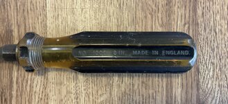

Here is one purchased by my Grandfather in that era.

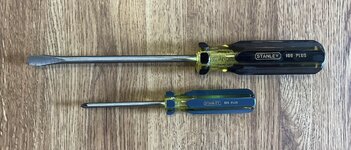

Sometime in the mid 1980’s Stanley in the U.K. re introduced the “100 Plus”. They changed the colours of the handles back to amber, with black or blue flutes. The blades were basically the same as the previous style though, so these were really “100 Plus” in name only. I quite liked them though, and bought quite a few. I still have new ones in my stores.IMG_2291.jpeg
They were, however, discontinued quite quickly.
You can tell a new “100 Plus” by the lack of a forged blade, and also by the varnished blade to prevent corrosion. The earlier ones were of better steel and didn’t need this!

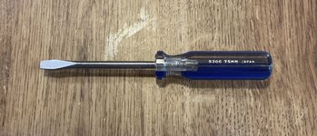

These drivers were imported to the U.K. from Japan in the 1980’s. The quality is quite good and the design influence is clear.
The Vessel “Crystaline” is obviously also heavily influenced. Strangely, Vessel don’t offer these in the U.K. or Europe where the style would be recognised.
