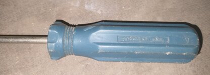

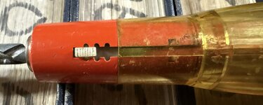

Hi, I’m new here. My husband was a very talented and artistic craftsman and he passed away. My sons and I were going through his old tools and I found this Stanley screwdriver with a plastic handle and I can’t find anything that looks like it at all anywhere. Can you give me a clue of what year this was made? It says: No. 1000 6IN.
CJH
May 23, 2022
2
Thanks so much Plumb. ( lol )
I looked at this catalog on the site( that’s how I found this site :)from 1934 to 38, and then I looked at the catalog from 1938 to 50. The shape of the neck was different on the ones from mid ‘30s, And the ones from the next group had the right shape for sure, but were black on the neck of the plastic which this is amber thruout.
I guess this is just a variation of an early Stanloid from around those times, that is just not shown in the catalog. I agree with your guesstimate!
And I just love this cool vintage screwdriver. It will stay in the family for sure.
The paint on it has probably just worn off over the years. I have a 1954-58 Stanley Handyman which should have a red thumbrest but has worn off except on the end of the handle.
It's a nice driver, I would suggest cleaning the rust off the blade and addressing the tip if needed and it'll give another lifetime or two of service.
