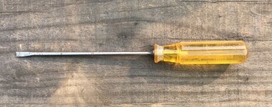

The 100 Plus screwdrivers are some of my favorites, although 2/3 of mine are branded Wizard. The other one is branded Stanley, and was originally a #1 phillips but somebody bent the blade 90° and when I tried to bend it back broke. So then I took it to the bench grinder and with a file tried to make it as close to a hollow grind as possible.

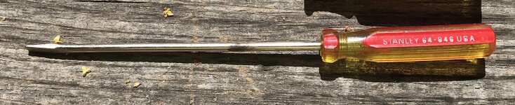

Here's a couple oddballs for you. I sold these a while back, but I thought they were neat:
Thanks I will add them to Part II. I wasn't able to find a NOS one with the package that I could get a date off of, but luckily Stanley registered Hi Glow, so I was able to get a first used date off of that; 10/10/1992. They also used the name Neon, which I guess is later.
